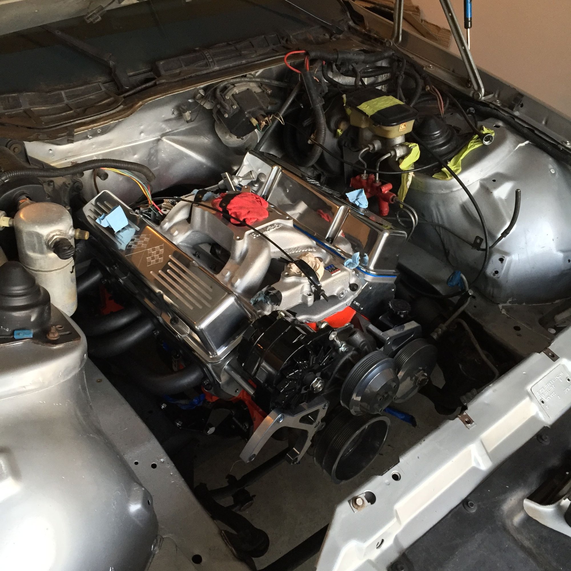

Hello everyone I'm new here not new to the site though been using advise from this site since I can remember, I just decided to finally create a account. I have a 1982 Pace Car and just installed a stroker motor in it over the weekend and just installed hooker shorty headers yesterday and only problem I ran into was on the passenger side(which I'm sure anyone with a/c in there car has ran into same problem) my biggest problem was it wouldn't clear the starter once I dropped starter went rite in. I don't see you being able to install headers and motor at the same time unless you do it like the pic above. Here's a preview of what I have
Clean b engine bay!
