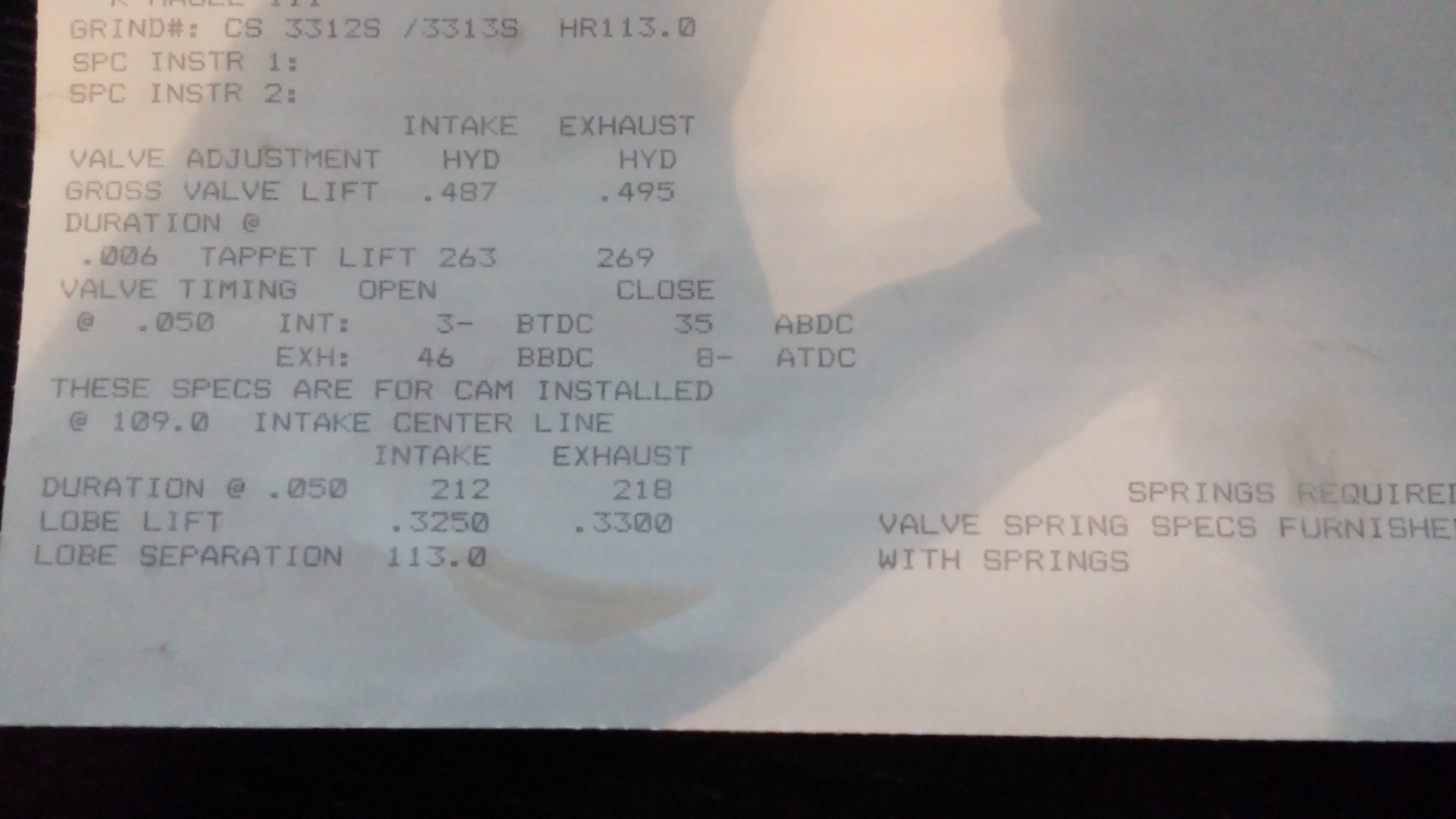

When I ordered the rotating assembly I told the salesman at Summit I wanted a 9.5:1 with 64cc heads. I have been looking for the receipt to find out what pistons were ordered. They are dished but, how much I am not sure. I did find the cam card. I do not see IVC listed on the card though.
Cam Card attached

Without information like the piston dish volume, piston below deck distance and the head gasket thickness, you could be a long way from 9.5:1. In either direction.
Is the engine in running condition now?

IVC is listed as INT: closed 35 ABDC. (Can't tell for sure if the number is a 35 or not).

Alright I found the info on the dished pistons. It looks like they are +16.00cc. Do you guys have an estimate on HP on this setup?
383
113 vette heads
mini ram w/bbk throttle body
Lift .487 intake ,495 exhaust
Duration @ .050 212 intake 218 exhaust
Lobe separation 113.0
