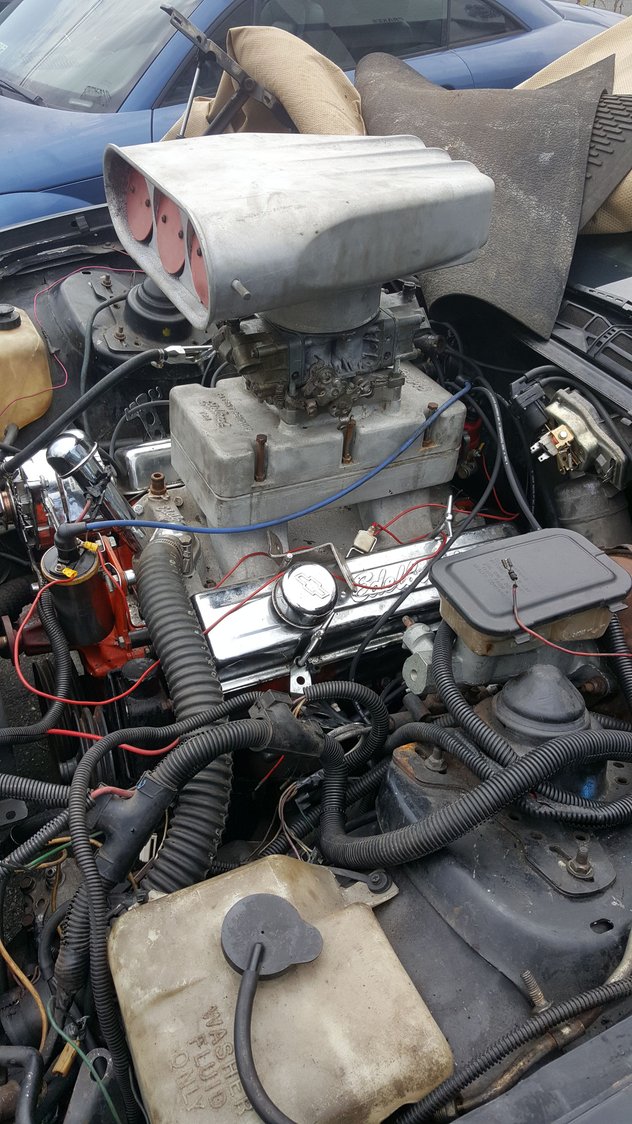

Re: Older 350
I've had a few third gens. This is a 82 ws6 so it's got all the goodies like gb9 exhaust, j65 brakes and lsd rear ect. Here's some pics of the bay, hope they don't get me banned. Yeah I know, no throttle response, terrible on the street, looks retarded, antique bread box tr is a gas bomb blah blah.
