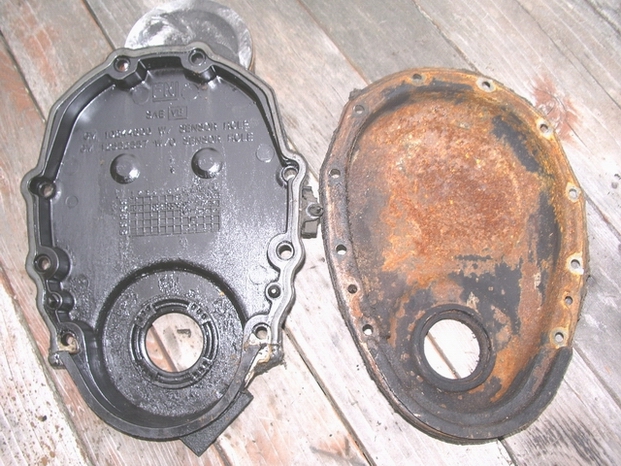

see pic
Std SBC intake on Vortec head
Re: swapping 95 older TBi 350 in place of a 96 up SFI 350, questions..
The block's water pump passages on the 95 have an internal bypass, while the 96 is external.
Isn't the front timing cover different too, bolt pattern & crank sensor?

hmm ok i see a pic of the two different styles now the '96 up TC are different bolt pattern than 95 down yep well that sux
so much for this swap job
damn
major fail..
cant put a 95 older sbc engine into a 96 up vehicle wow...
bad...
damn
major fail..
bad...
