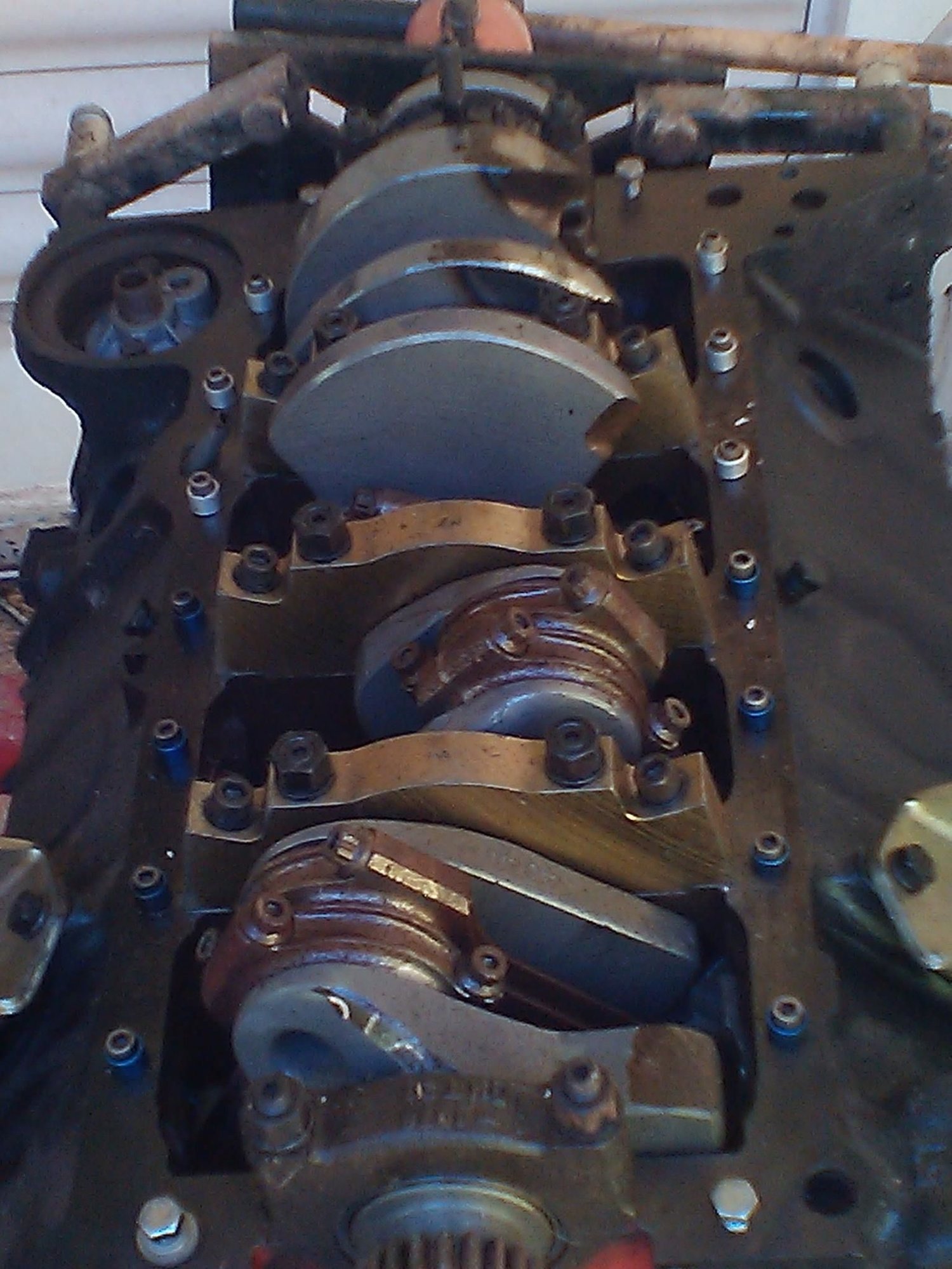

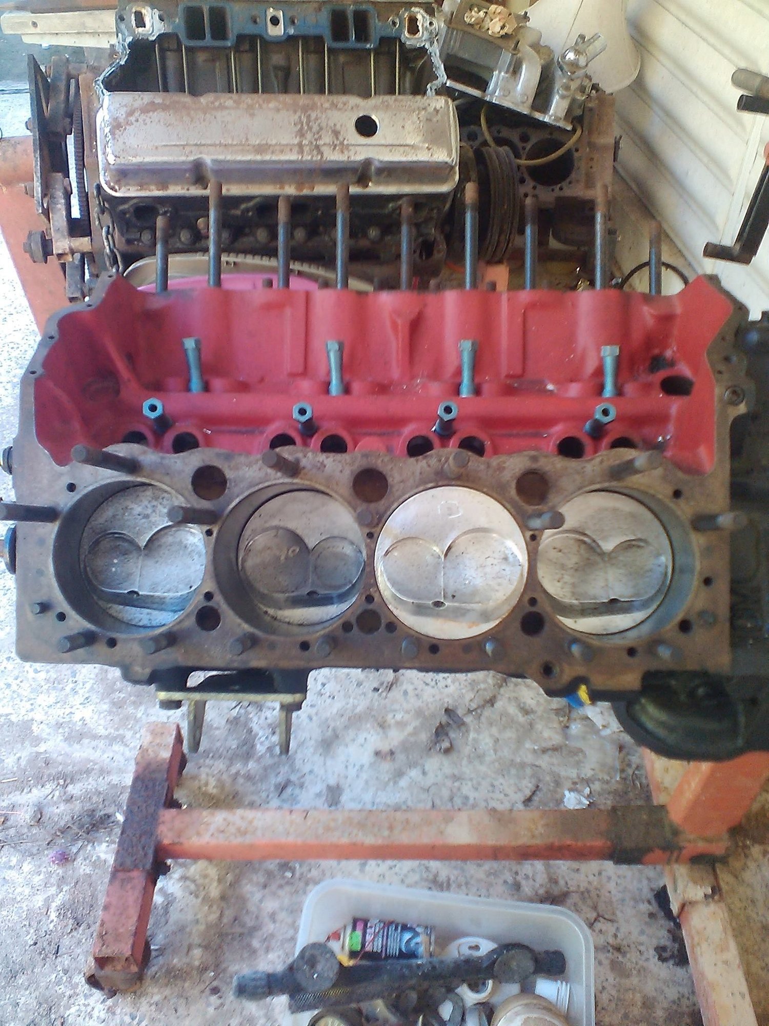

I've been offered a 400cc (destroked with 350 crank) SBC short block with high compression forged pistons, H-Beam rods, billet 350 crankshaft, splayed caps for $500.00. The question is can I order some high volume combustion chamber heads in order for me to run 8psi of boost or should I will need to replace the pistons. I will also need a special flywheel in order to use my T56 6-speed in that older block.
So what do you guys think????

I would be weary of gm oem 400's and boost. But find out what the piston specs are. They look like pretty big domes. You can still find 72-76cc aftermarket castings for heads that will help lower things down. Destroked helps lower compression too

I would probably run a set of 72 cc heads with those pistons. Even though I have run 64 cc heads before with forged flat tops with no issues until I put too much timing in and popped a ring land.

i wouldn't touch that engine with a 10 foot pole. It needs a full rebuild based on the pics above IMO. Some would clean it up and run it but I wouldn't. If it was allowed to get that dirty and rusted up, who knows how it was machined/built.
If you can get if for free or wait to pay until you tear it down - pull it down, clean the block and all parts, measure all the bearings and fits, and maybe get lucky and reuse most/all of the parts. Otherwise i would build the 350 block you have. I deal with spare machinery and "known to be good backups" for a living and 99% of the time they turn out to be junk when torn down and inspected.
