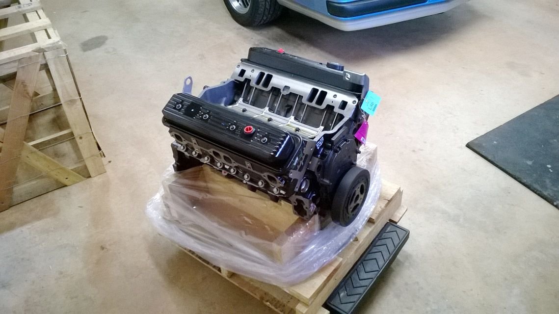

Seriously considering L31 swap into my Formula. Currently has a TPI swapped onto LO3 305. I know pretty much everything will swap over, and I've poured over this forum for answers to many questions. There are a few things, though, that I'm not clear on and would like some answers before actually ordering the engine and intake from S-D.
1. What BIN should I start with? Anyone out there have a good-running L31 TPI BIN that I could take a gander at?
2. I'm currently running an AXXB memcal through a G1; will I need to secure an L98 memcal?
3. Currently running Bosch III 19 lb injectors; will these work with some tuning, or will I have to swap out for bigger injectors?
4. Harmonic balancer: should I use the one off of my LO3 or can I just use the one that comes on the engine?
5. Will my Hooker Y-pipe work as is or will I have to alter it?
6. I'm shooting for 260 hp/375 ft/lb ballpark; will I be able to achieve this with the stock L31 cam?

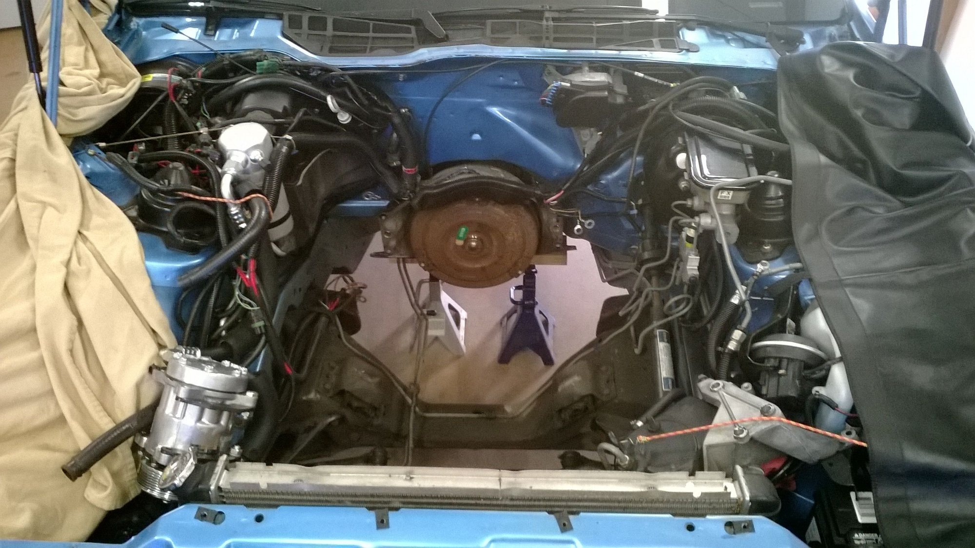

I'll let you know. Got the LO3 out yesterday, so now it's time to "stick" the new one.

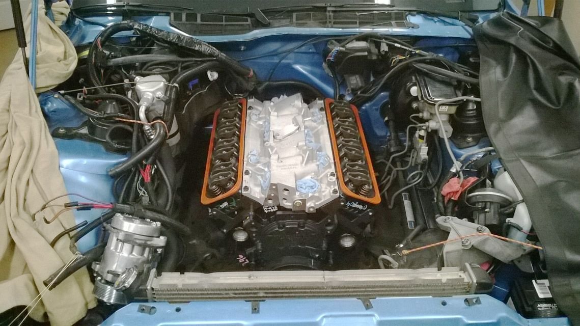

New engine is in...!

Looking sweeet. Did you do anything to that intake or do they come like that?

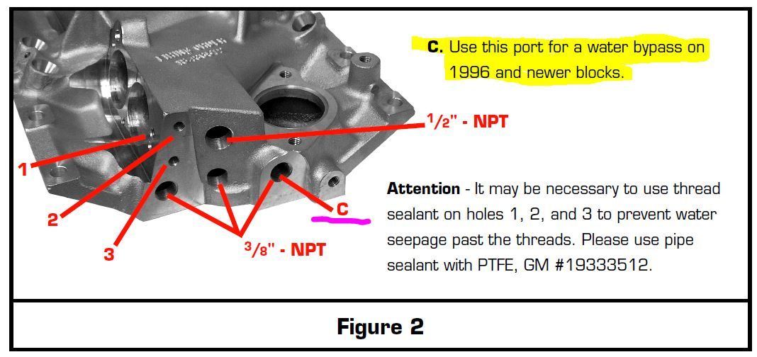

Only thing I've done to the intake so far is install a plug in one of the front ports (the one that's pretty much in the center front of the manifold) and installed the EGR delete.

Isn't that center port supposed to run to the top port on the water pump? To compensate for the coolant passage the Vortec heads block doesn't have? Might want to look at the Scoggin-Dickey article on the intake. Not sure it even matters, but it is a feature exclusive to the Vortec intake, Now the other extra port is for the cold start injector switch, which I'm assuming you're not using.
Edit - More info...
Old Nov 25, 2019 | 08:12 PM
Fast355's Avatar
Joined: Jan 2005
Posts: 10,450
Likes: 510
From: Hurst, Texas
Car: 1983 G20 Chevy
Transmission: 4L60
Re: L31 TPI swap: A few questions
Edit - More info...
The Vortec heads do not have a bypass port.

Thanks, Drew, I will check it out. That center port (C) can't be used on an F-body, as the fuel lines block access to it. The port directly to the left of "C" is where I'll be running a hose to the water pump. Port to the left of that will be for CTS. Top 1/2-inch port will be for the heater bypass.

Okay folks, please correct me if I'm wrong, but it seems to me that the stock heater core diverter valve already accomplishes the same thing as running an extra hose to the water pump. When no heat is called for, the stock valve diverts coolant from the restricted nipple in the front of the intake manifold directly back into the passenger side top of the radiator. Would this not provide some coolant flow through the engine/heads until the thermostat opens? Is the problem that it would not provide enough flow?

I couldn't say either way. The issue is the later blocks/vortec heads don't have the bypass port that lines up with the TPI water pump. Depending on what theory you buy into for the bypass port in the earlier water pump/block/heads, maybe you don't need it. But that's why Scoggin Dickey added the extra port. Use your best judgement.

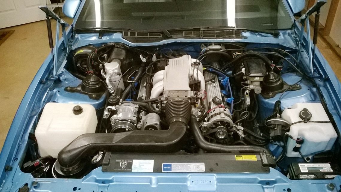

It lives! Runs and idles great, once we got the distributor in properly; one tooth off so it was running more than a bit retarded at first. It was also running a bit lean on the stock AUJP VE tables. Bumped one point across the board to the VE before test drive and it's in the ballpark. Now more data logging and tuning. Thanks to Brian (tuned performance) for the SA tables.

Just an update: Everything is working good since I replaced the memcal that developed a bad knock circuit (thanks, Brian!). FWIW, I burned a chip with the stock AUJP SA and it seems to like it. Much snappier; took out .7 degrees at one spot where I got 1 degree of knock retard and haven't recorded a knock event since. I'm running premium "real" gas and, along with the stock L31 cam, seems to handle this SA just fine. Still fine tuning the VE but, honestly, is probably good enough for a mostly stock setup (+/-5 points on last data log). Outward appearance of the engine hasn't really changed and the hood still has the "5.0 FI" decal. I thought about updating it to the "5.7" decal, but they want $40 for two little decals, so I think I'll leave it for now.
Also wanted to express my gratitude to the many, many knowledgeable and helpful folks on this forum. No way I could have done this without the amazing resources available here.
