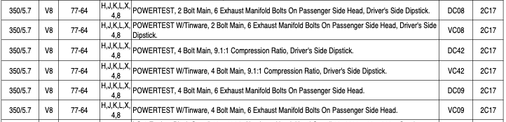

The construction company probably had a fleet service with an engine remanufacturer. If they used ATK, there may be a tag or stamp on the engine. The rebuilt long blocks for a 1977 chevy 1 ton pickup are coded as VC09. I visited an ATK shop years ago when I was researching my engine swap project. It seemed like a good operation, but the reviews on Google are mixed. Fitech is a good start, but a trip to the machine shop would be prudent If you want 400 hp.
https://atkvege.com/fleet-accounts/
