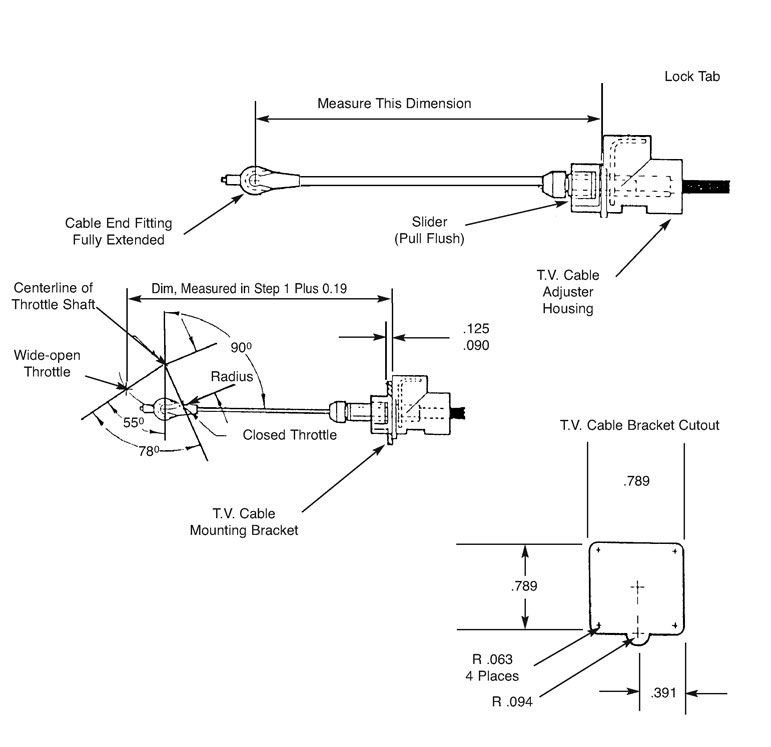

I was wondering if anyone had made or purchased a bracket that will allow a 700r4 to mount to a ls3 intake manifold along with the accelerator cable. I have searched forums all over and have not found anything.

If you get the geometry set right, there shouldn't be an issue. Regardless where the new engine makes power, unless it's unbelievably different, everything will work just fine.
The key phrase there is "correct geometry". and if you haven't checked into just how precise it should be, then you're going to have problems.
To build this into a stand alone bracket would take quite a bit of work and some decent skills but it certainly can be done.
Not only the distances but the radius must be carefully plotted.
