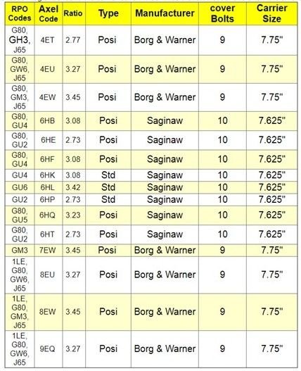

Start with the basic. Decode your VIN and RPO codes. Look-up on internet you'll find online decoder. That will give you some basic info.
What's your intake? TPI (LB9) or TBI (L03)? Most likely it's a TPI
What transmission? T5 (Manual) or 700R4 (auto)
Rear end? You need to check the RPO code
T-Top or not?
If TPI you have a Mass Air Flow system (MAF). TPI's where different throughout the years. By understanding your drivetrain and induction system, you will be able to plan upgrades.
