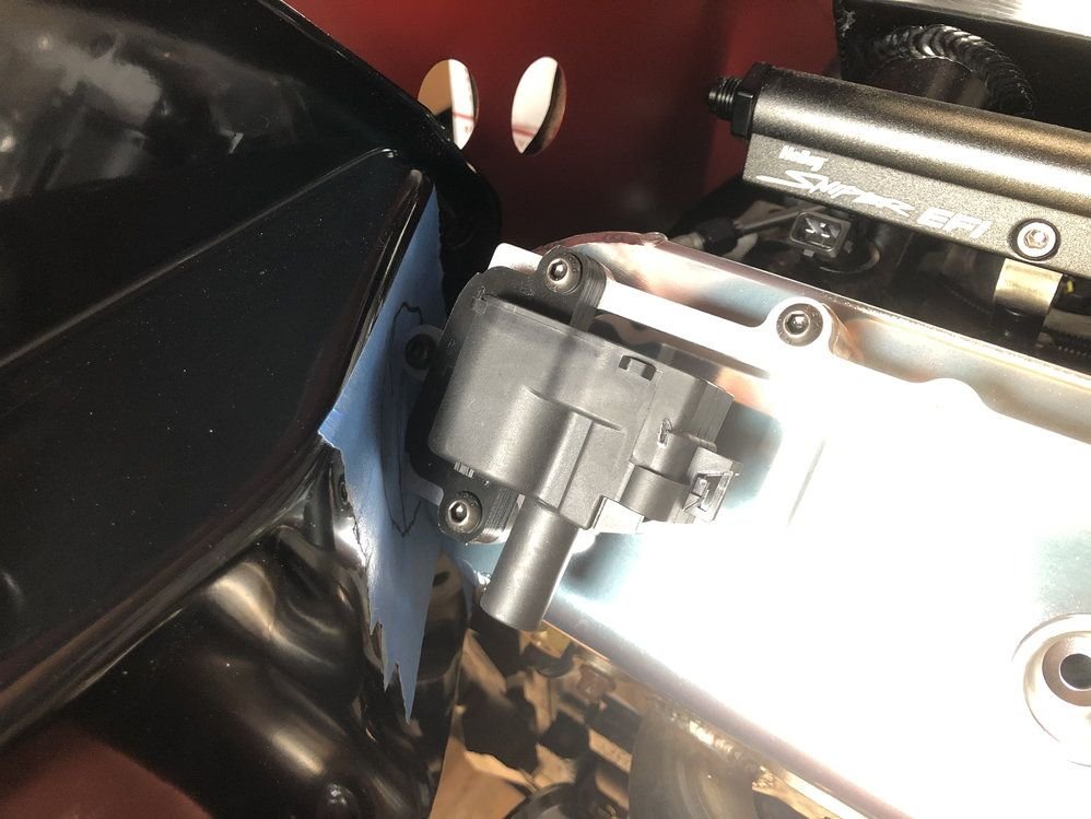

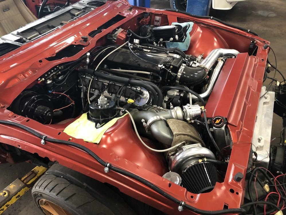

Re: Turbo Lq4 heater box
I pretty much have this exact setup in my TA. The non a/c heater box leaves plenty of room for the down pipe. Only issue I ran into is the Sniper valve covers I’m using were a little tall so I had to slightly dent the heater box for clearance. You can check out my build thread here
thanks a lot man this helps out big time 👍👍👍👍
