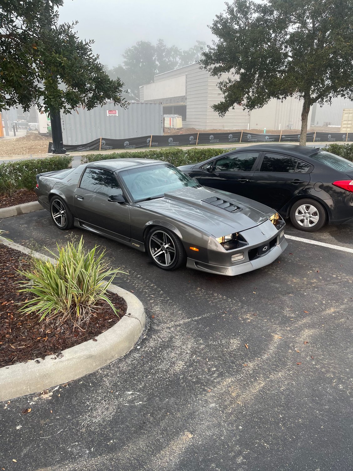

Hello I’m new to this group. I have a 1992 RS 25th anniversary with a 305 TBI with a T5 5 speed. I am doing a 350 LT1 swap from a 1995 firebird. Can I use the stock harness from the 305 that’s in the car now? The motor should make about 550whp when done I have a P1S procharger for it. Don’t really want to go aftermarket ECU like Holley ECU as the pockets aren’t that deep. Thank you. Of if you guys know another stock harness replacement any from from the 5-$700 range if the stock harness cannot be used.
