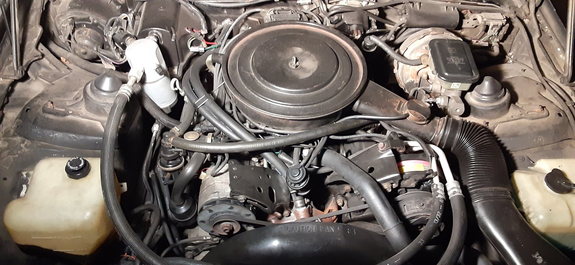

hello and thanks to the guys who responded. The custom computer programming sounds like something that will cause endless head aches and never work right .. so i was thinking about the 305 - It runs as good as it ever did - no smoke, no leak, no cooling issues. What modern upgrades are available these days for an all original 305? 83 sport coup 5 speed overdrive, a/c is only option.. Looking for easy starting, smooth quiet running, reliable, gas mileage, would a new fuel injection sysem make a big difference? new modern a/c?. other electronics? What are folks doing these day with the pollution pump? And what litle plastic thing-a-ma-jigs should I expect to break at any moment and I should just go ahead replace? here it is in all its glory --
