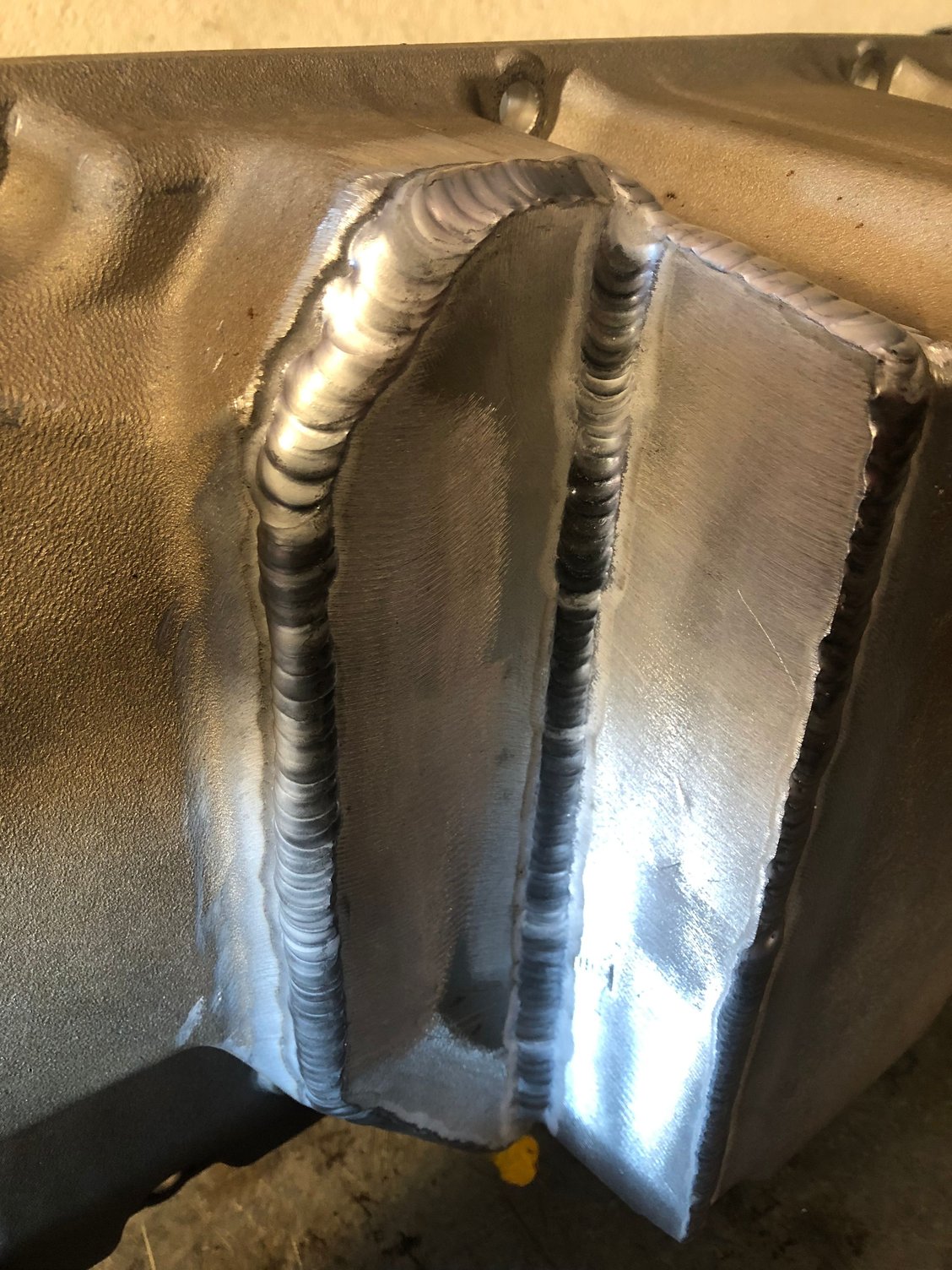

Oh yea that’s right so for this I used an AJE Kmember with their mounts. I had to mod the mounts a bit because this one uses for mounting holes the AJE one didn’t lined up also I had to Notch the oil pan to clear the Kmember. For the headers I had bought some OBX headers for the Zr1.. I’ll tell y’all these where easier to install than the hawk budget headers I had on the swap. The driver side collector did need some work but it wasn’t to bad. I’m also running Texas speed true dual exhaust 3” over the axle. They do hand a lil by the diff but can move them up a bit.
This is how much I notched the oil pan.. I know some said I was nuts to do that .

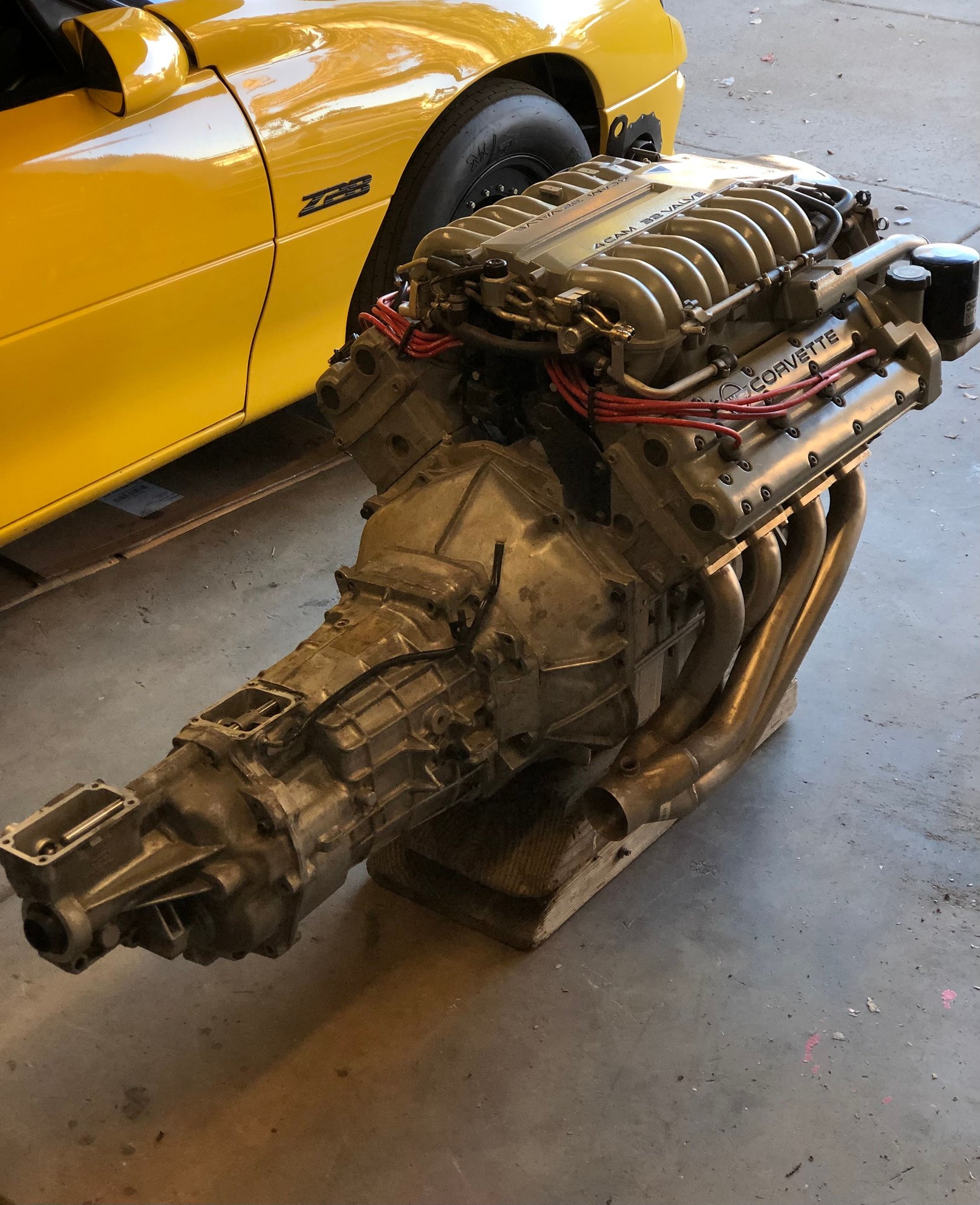

Mocking up the T56 which I had to convert to an LT1 style. I did have to notch the bell housing on the passenger side for the header collector to clear
LT5 next to the Ls1
