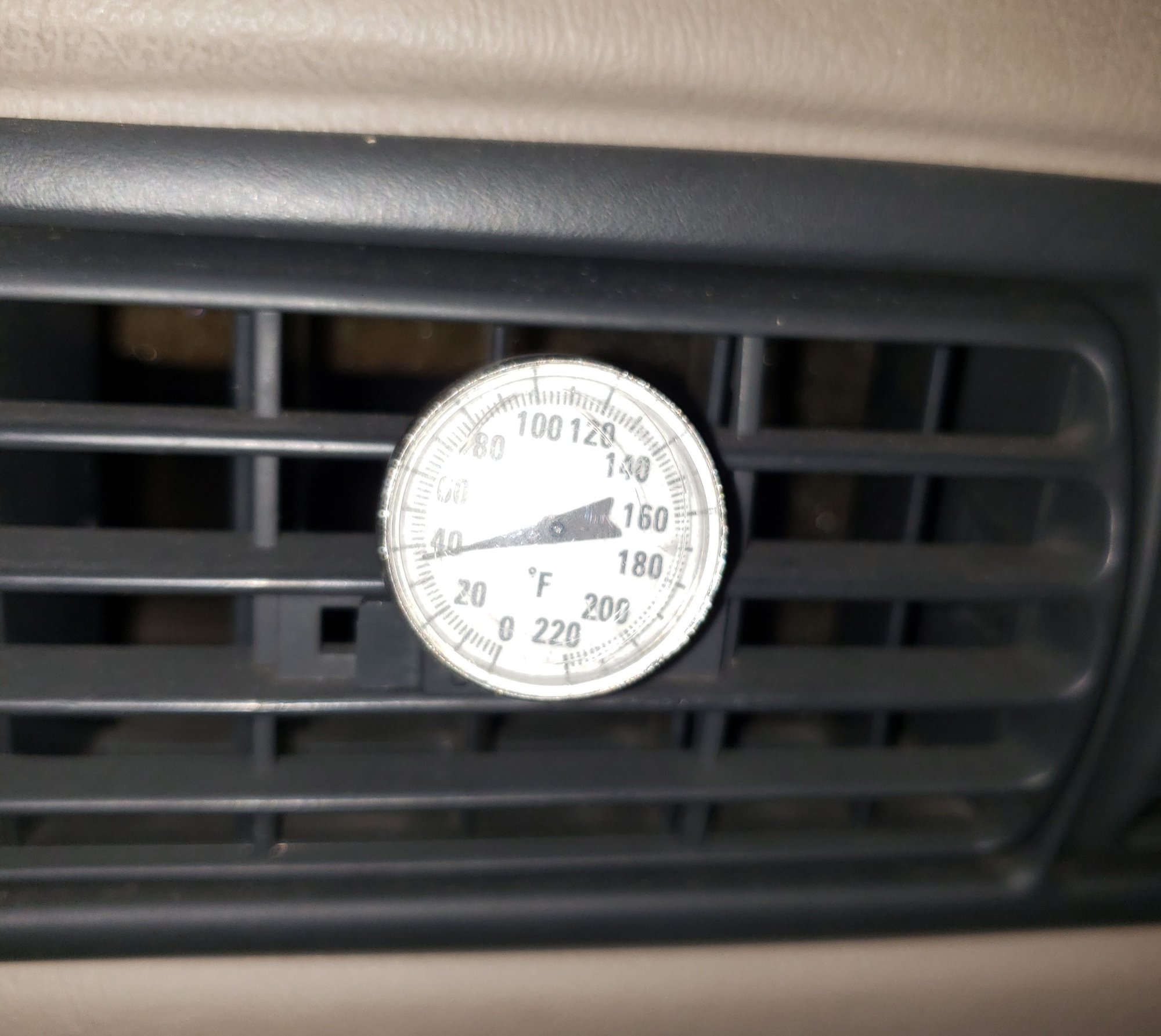

Actually they are designed to go a bit below freezing on cycling clutch systems. A light layer of frost, causes the low side pressure to drop from less heat transfer, forcing a cycle. I have also watched newer vehicles with electronically variable displacement compressors. The newer vehicles will command target evaporator temperatures well under freezing, then they will back off the cooling a bit every 3-5 minutes to melt any accumulated ice.

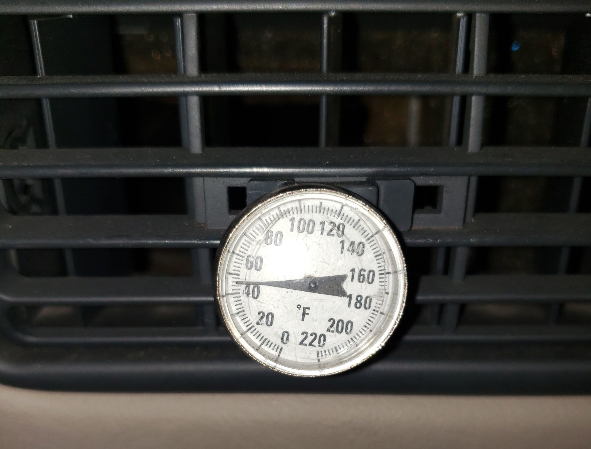

After recalibrating the adjustable cycling switch, the temperatures can get down to freezing or below and when the compressor cycles the ice melts away. My 97 van hovers around freezing and I could drive it all day long with the vents near that temperature and the compressor cycling without freezing up the evaporator core.

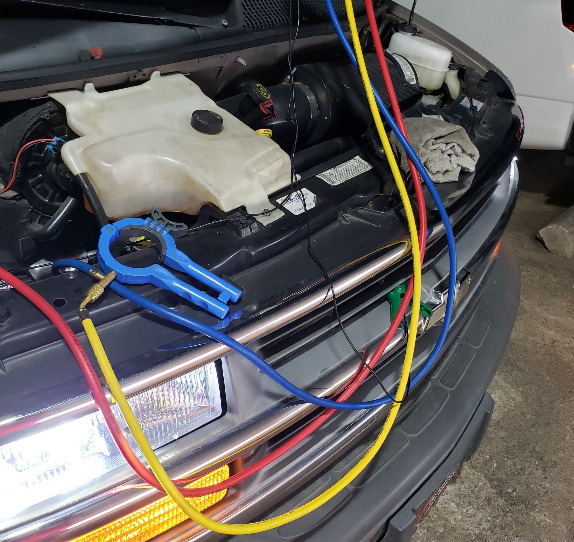

This is my buddies 93 Yukon, R12 to R134A conversion Sanden, Parallel Flow condenser, NBS GMT800 electric fan conversion, and an older adjustable cycling switch. This is his suction line with the blower on low, before the compressor cycles in ~100°F weather. If you are not getting the lines to look like this and then cycling the compressor to melt the frost off, you are giving up system performance. The cycling switch shuts off the system at about 21 PSI on his truck and turns it back on around 40-50 PSI, plenty of time to melt off any ice built up in the evaporator core.
