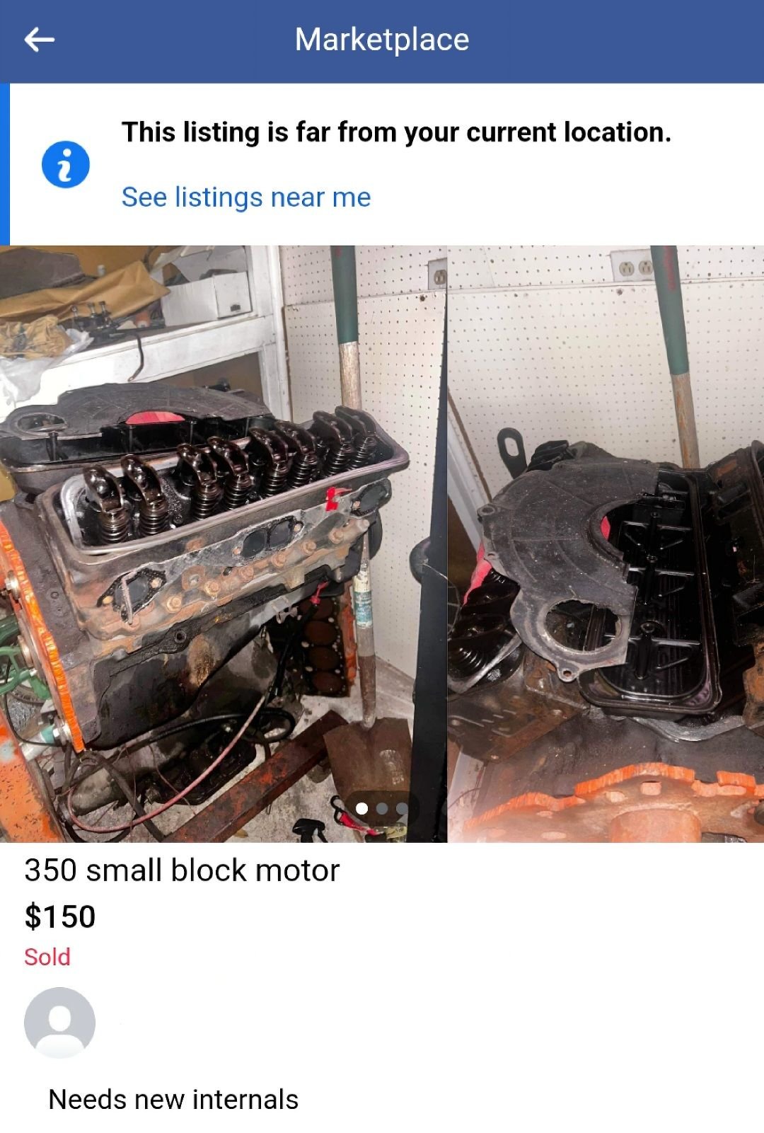

Long block 2blt vortec 350 (062 heads, crack free, bottom end smoked from low oil pressure): $150 (got my heads)
Short block 4blt vortec 350, remanufactured by ATK sometime recently, left in the rain when someone pulled the heads: $125 (got my short block with near new internals)

I unfortunately didn't take any pictures of the engine tear down, but I will take pictures of assembly. I have screenshots of the ads I purchased the engines from that I will eventually add as well.

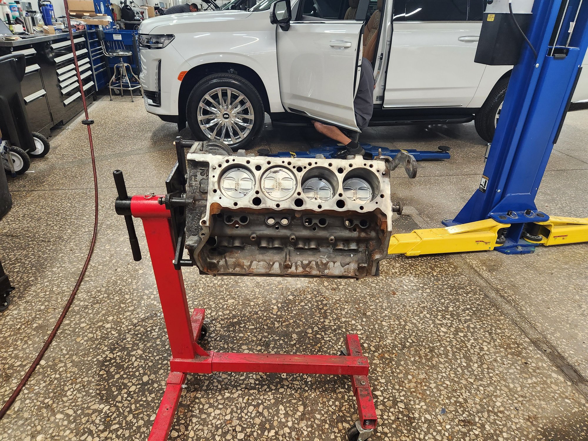

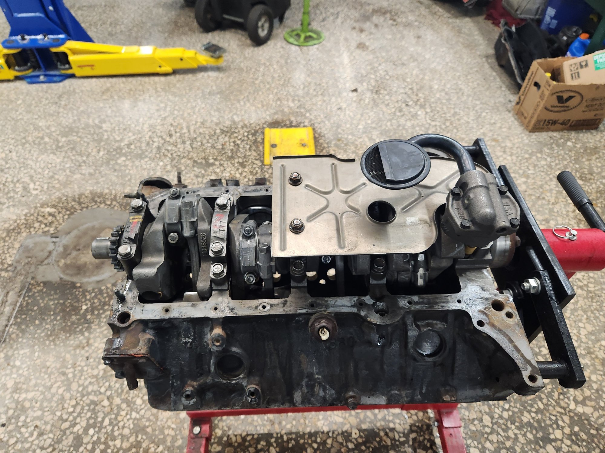

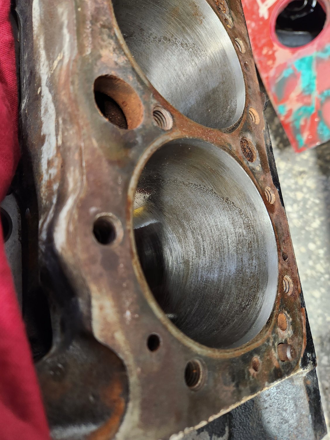

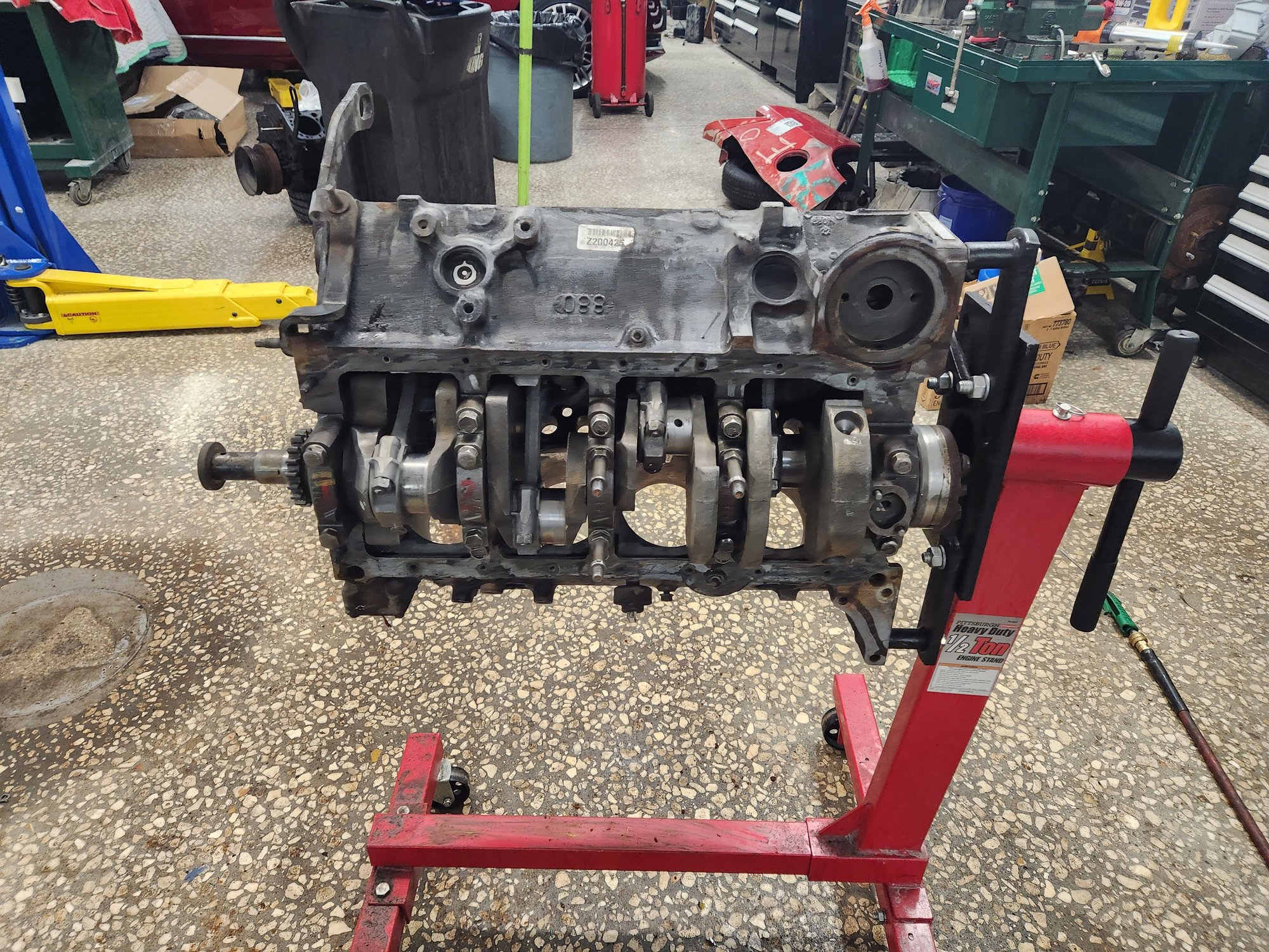

I'm lucky to have a cuda parts washer at work, so I cleaned everything overnight Monday and started assembling with what I have now. I honed the cylinders with atf in a spray bottle and a 220 three stone hone. The staining on the cylinder walls looks far worse in pictures than once they were cleaned with soap and dried. So im running it as is. I'm happy with how everything came out so far.
