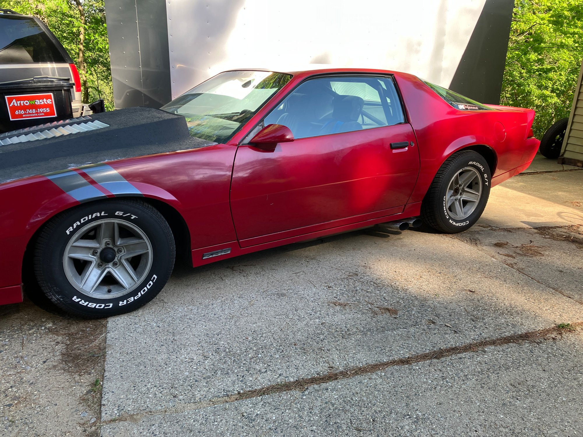

Hi guys , I’m looking for advice and or opinions! I have a 1986 IROC Camaro. 305/ auto. Bought without the engine. I’ve worked with small block chevys all my life and thought of possibly going to the LS engine. 4.8 / 5.3 or 5.7 . You can’t help not hearing how great these are and I’m sure they are. However Hawks 3rd gen tells me I’m looking at 4 to 5000 for the swap alone and while people say these are cheap engines I can’t find one in decent shape for less that a grand. Bottom line with all the hassle of the LS engine is it worth the time and$ to do ? I have a zz4 350 in another Camaro and it runs great ! Thanks again

Thanks for your advice, I’m sure the LS is a great engine how ever I just don’t see any clear advantage to it for the $. The 86 iroc I have is complete minus engine, I just can’t see putting 6 or 7 grand in this thing just to have an LS engine. I’ve always been a small block fan so I’ll just build a 383 and see how that goes. Thanks again!!
