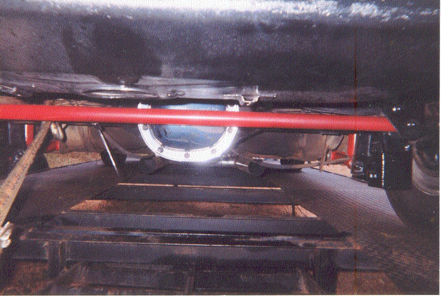

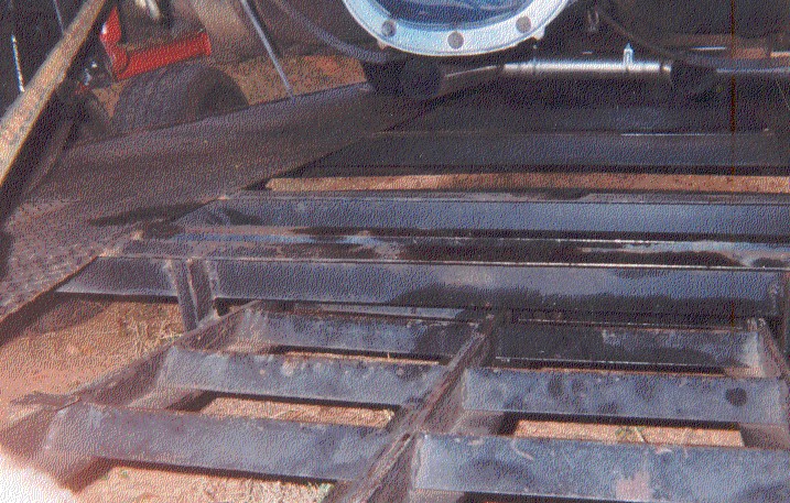

Here's a few pics of mine. I have 3" duals with a Flowmaster H-Pipe kit. These pictures are taken with the Mufflers off, but you can see the the crossover pipe. I run Flowmaster 1 chambers, but I took them off at the track one night, and the day I took thses pic before unloading the car. I have a sound file for this car in my sig, but sometimes it doesn't work. If you can't hear it let me know, and I will E mail it to you. I don't see where a X Pipe would a problem to run, but the H Pipe kit was only about $40, and I needed exhaust on the car so I could drive it.

The pictures are not showing . I want to run this same exhaust also , could you email me the pics ?

1990GTA, you have mail!
