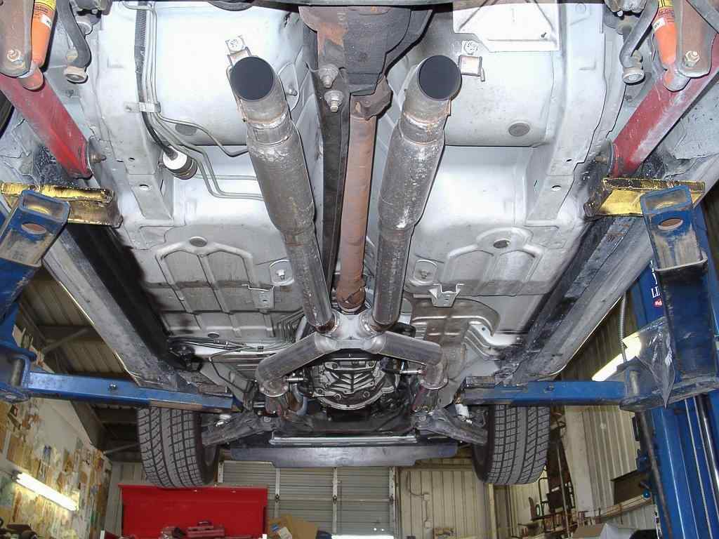

I know how I want my dual exhaust system to work and I know where to get the parts. The problem is that I don' know how it's going to fit underneath my car. I'll be using hooker comp headers, 3" oval tubing, and spintechs cruiser series mufflers(2 1/4" thick). I 'd like to use an x pipe if I can too. After looking underneath my car, even with the low profile mufflers and oval tubes, there isn't going to be much ground clearance. BTW, I want my system to be like this, headers into the pipes, x-pipe, then I want the mufflers to be right before the rearend with the tips facing the rear tires( I don't know if I explained this right). If I lifted the rearend up a few inches would there be enough clearance. Thanks for any help or other ideas.

one of the best examples I've seen:

Wow, that's pretty much exactly what I want except I had different mufflers, thanks Tas! BTW, what kind of mufflers are those? Are those long tube headers, too? That x pipe looks like it might be in the way if you wanted to do a tranny swap, maybe it's just the angle.

They look like dynomax bullets but its not my car(dammit!) so I don't know. http://www.dynomax.com/mufflers.stm

Also just happens to be a 4th gen....
