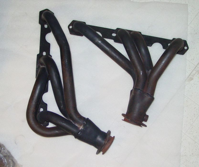

1.5" primaries, 2.5" collectors, and 2.5" ypipe. Everything is pretty small as far as headers go, but I'm guessing that they are a little easier to work with. I installed a set of Hedman or Hookers a number of years ago with the 1 5/8" primaries and 3" collectors and those took about 12 hours to install because the engine had to be unbolted and jacked up to fit the drivers side header in.

I have the Flowtech's and they work pretty good.
They have 1.5" primary tubes and the Y-pipe is kind of a turdball, but for us poor (cheap bastads) they are all right.
I'm going to re-use them when I install the 350.
I'm going to be working under my Z this weekend and i'll get some pics.
The only time I've scraped anything was when I Banzia' d through an intersection and caught some air time
