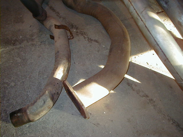

I swapped the L69, which I believe is the same as the TPI, exhaust into my LG4 (It was pretty much a free-be). Difference in the two--huge. No doubt that headers would be better, still.... Here are the y-pipes in question.

The stock intermediate pipe is larger than the aftermarket that I previously had as you can see.

OMG!!!! That big pipe could eat that small pipe. lg4 stuff is TINY
