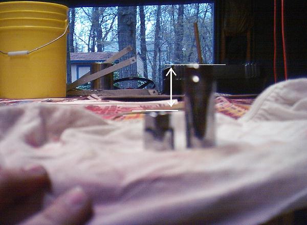

my dad just got home and he cut the plug socket. he also at to drill out the square in the middle (were the drive goes), so that it would go over the plug. heres some pics ot the new vs. the old socket.
oh yeah it works amazing. you should all try it.

A buddy did this with his.....
