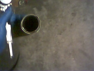

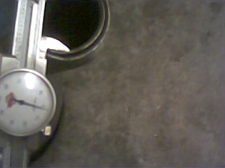

Originally posted by SSC
If anyone has bothered to cut thier factory Y pipe into small peices especially an LG4 peice and compare it to a FTY there would be no comparison to factory Y's ever made again.
Just go back that statment up a bit. Here a cutup from my birds LG4 Y pipe. The pics kinda suck $20 camera. The ID on the big end of the pipe is just a hair over two inches. If you cut into the pipe thers another pipe that even smaller 1 7/8 to be exact. At least the FTY is 2.5 OD pipe for what it worth.

Opps. #1
