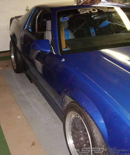

A little better pic of the nova in street trim and a little vid at the track

Attached Thumbnails Fabbing the side exhaust with plenty of clearance (aka NASCAR Boom Tubes)-may26nova001-2-.jpg
