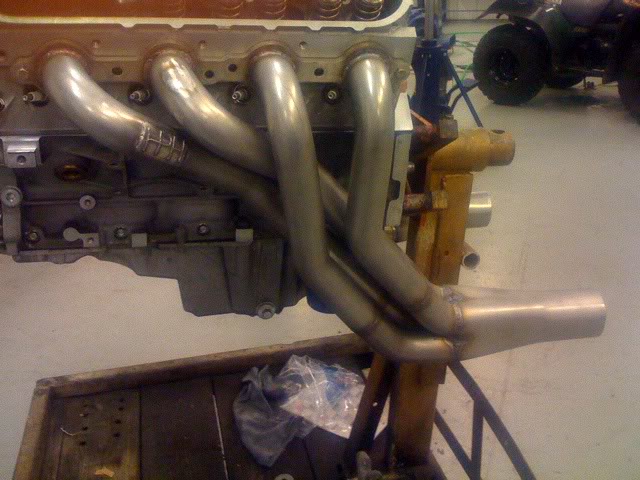

Originally Posted by stage20
they are a custom set.
damn thats sweet. any pics?

this is a pic when they were built.
the heat hides the different colors in tubing. they are all the same tone.
dude that built them did a NICE job.
doubt they will clear a stock k member, but these were built for drag setup.
