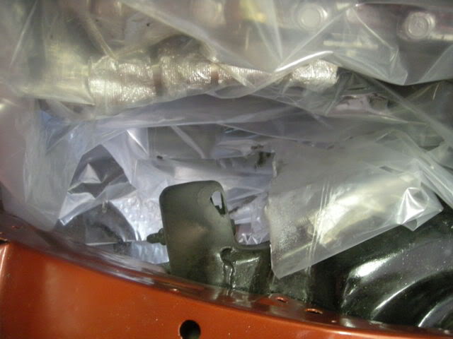

If there long tubes its normal, You'll have clearance issues with or with out poly mounts too.

Transmission: TH400
Axle/Gears: 4.10
Re: hedman header problems on b4c camaro
so what all did you cut and customize huh??
Old May 9, 2011 | 06:13 PM
one92rs's Avatar
Joined: Jan 2009
Posts: 2,928
From: league city
Car: SOLD!!!!!
he cut o notch out of the crossmember.
then he cut a notch in the a arm mount and filled them in.
fueled soul i cant wait to see it all finished.
