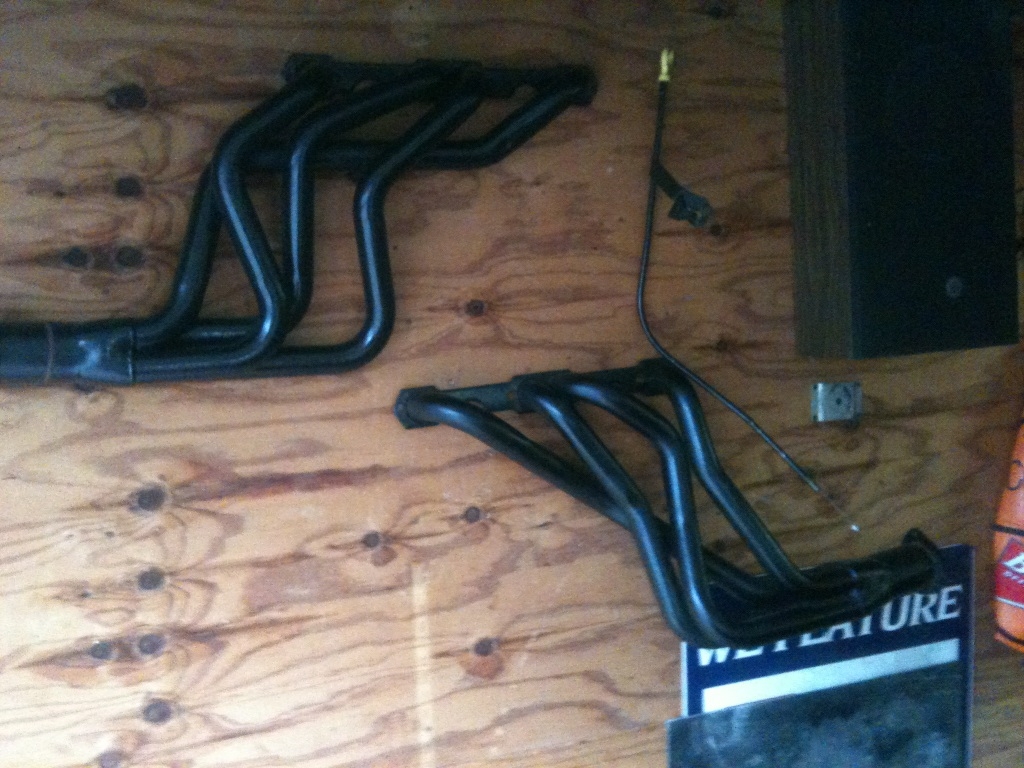

anyone reconize these headers?

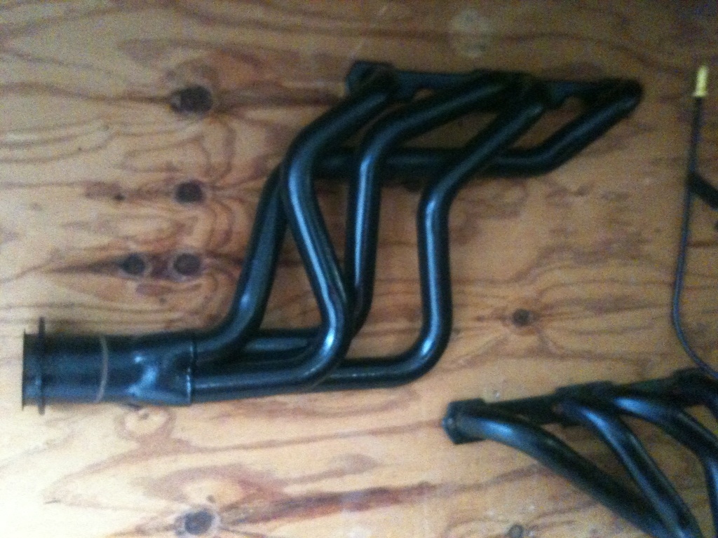

i bought these headers right after i got my 350 and i cant find any maker markings on them or numbers or anything, the are long tube headers with 3" exits
Attached Thumbnails anyone reconize these headers?-header.jpg   anyone reconize these headers?-headers.jpg

Re: anyone reconize these headers?
those look like Dynomax/Blackjack/Summit/Jegs headers for a mid and full size GM car with a small block.. so 64-87 Malibu, 65-89 Impala, 67-81 Camaros- things like that.. look on the collector, i bet there is a "001" stamped in there somewhere.
Your right, I found 001 and 19. Wonder if they can fit my camaro
They won't fit a 3rd gen
reason?
reason?
They are made for a different car? From what I gather the collectors hit the floor/firewall, the one on the primairy tubes on the ds IIRC is in the middle of the k-member. Probably more, but they won't work without cutting them up and rebuilding them. I believe someone here made a set work, but its not really practicle.
You can get 1 5/8 headman LT for like150bux, or hooker/dougs for 4 and up if coated. They are made to fit and will with little drama
They're a summit brand and hes right. I tried using them in my 86 camaro. Got it to work but things had to be heated up and bent with way more custom work than I care to explain. Biggest waste of time ever.
