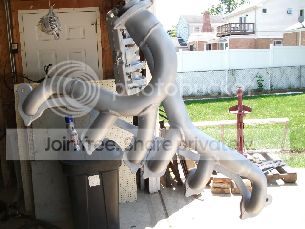

High-Temp exhaust paint works very well, so I'd give it a shot.
It gets a bad rep because people regularly misuse the product. The headers have to be blasted clean, and the paint needs to be cured properly.
Most people paint over rust, and just slap them on the engine without curing. Then ,of course, it starts to peel and we end up with 'This header paint sucks.' threads.
I used some VHT Flame proof header paint on my XJ Cherokee and it's been awesome. No problems, discoloration, or peeling.
