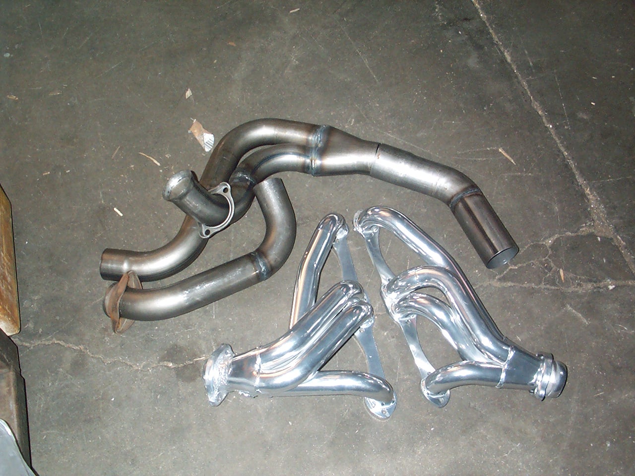

They only have an 1 1/2" primary, the smallest I ever seen. Dyno Don's are 1 3/4" and hookers are 1 5/8", plus they have a flange that requires gaskets that are guaranteed to blow out where as Don's has a ball and socket connection requiring no gasket to fail.
Just saying.
