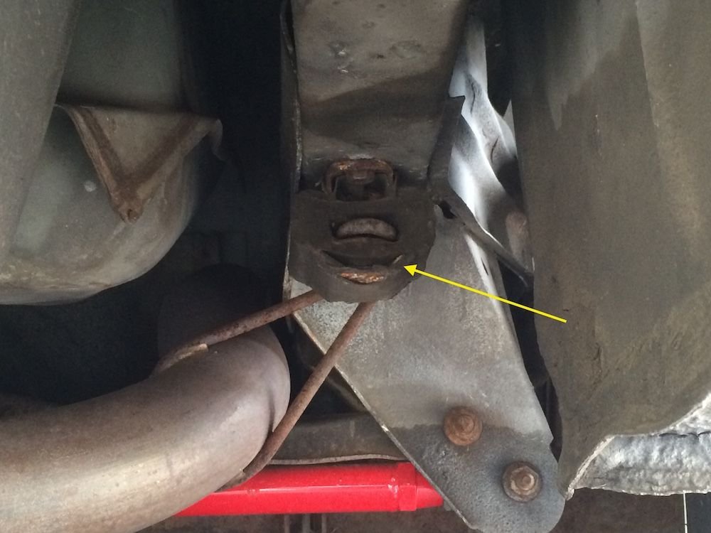

PN# for Exhaust hanger for the over/axle pipe on Pass side?
My exhaust hanger there is giving up the ghost, its allowing the over the axle pipe to bang against the rear pan hard brace. I attempted to shim the bottom of the rubber a bit, and it helps, but its still worn out enough that it allows the engine torque to bang the pipe into the brace.
Does anyone know the PN# to replace it? I couldn't find any record of anything in the usual auto stores.

Re: PN# for Exhaust hanger for the over/axle pipe on Pass side?
This is the one I'm talking about.

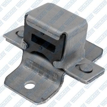

Walker PN 35648 looks different from yours, but is a huge design improvement. Just about any parts house carries it. It is made so the rubber is boxed in and won't flex as much.
Yeah, I saw the walker one on the website, but it doesn't look very nice. The rubber looks like it might not absorb enough vibrations from the exhaust.
Walker Exhaust Hanger 35648. CR GM PN# 10275709
I bought these for mine. It is a lot more beefier in person than the picture represents. It's pretty stout
35648
