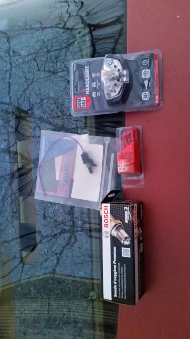

This is what I got from the store.
I hope I’m in the right forum, while inspecting under my carI noticed that the sensor on the passenger side exhaust was not hooks up. Ifigured it is the o2 sensor so I rush off to the store a got a new one in hopes it willsolve rough idle problem. But back to the point, when I tried to hook the newsensor up it did not fit into the only plug that was hanging down. The sensor has around end and plug has a oval end.
What am I doing wrong?
I’m I asking for the wrong part?
Has the car be modified from stock?
Or I’m I trying to connect it to the wrong spot?

Give us a picture of the plug and sensor in question.

Vee-Six O2 sensors are in the passenger side exhaust manifold.
I believe that all one-wire GM O2 sensors have a round connector. You're probably trying to hook up the sensor to the wrong connector.
Like others have said, photos of what you have in the car now would help.

I got a new bracket from a member on here good price I might add. When I went back to figure out the o2 sensor wiring for the life of me I could'nt find the wire it connects to. After doing alot of looking under the car I found three cut wires. Purple, Green and White/Black wires tucked away on top of the transmission. I do not know what these wires go to. I looked online at the wire charts for my car and still have no idea what these wires are for. Any ideas what was on the end of these wires?

The O2 sensor wire is purple in GM cars; not impossible that the cut purple wire you have, should be the one for that.

Thanks for all the feedback. I ordered the o2 plug and is going to hook up to the purple wire and see what happens. After doing some research on here many threads says the 2.8 v6 do not have an knock sensor so I take it that it is the fan temp plug.

**UPDATE** I finally address the mystery purple wire under my car. Connect and o2 sensor up to it and run alot better plus it do not reek of gas when it's running.
