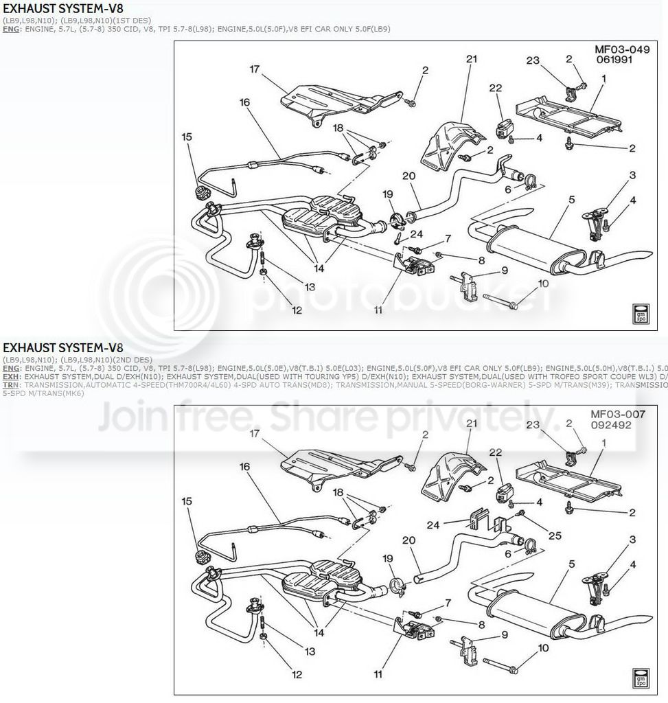

They're not too terribly common but there are definitely two designs out there. The later setup (2nd design) uses a slip joint with a band clamp, as well as the 4th gen LT1 style hanger on the intermediate pipe by the muffler. I've always considered it a mid or late 1991 change, but it could have been 1992.
Note in the diagrams below 1st Des/2nd Des. Different outlet on the Y-pipe, different clamp, different intermediate pipe.

That is very good info to have. Seems like quite a few small changes came out around 91.5.
It shows I have a NOS N10 (with the rpo code decals on the head shields) that's the second design.
Have a few very late 92s that I can check out to see what clamp is on them but no 90s or 91s w stock exhaust.
Interesting, thanks!
I've always chalked it up in the same category as the rough textured runners, black valve covers, blank throttlebody plate, red auto trans dipstick, orange/brown TPS connector, etc... All running changes that popped up near the end of the line.
I don't have a picture of the clamp used on the later setup, but it's the same type 1" wide band clamp like they used at the intermediate pipe to muffler on the late thirdgens and on the 93-up LT1s, just larger diameter. I'd imagine someone figured out they could save money and the flange/V-band clamp isn't the best about sealing anyway.
