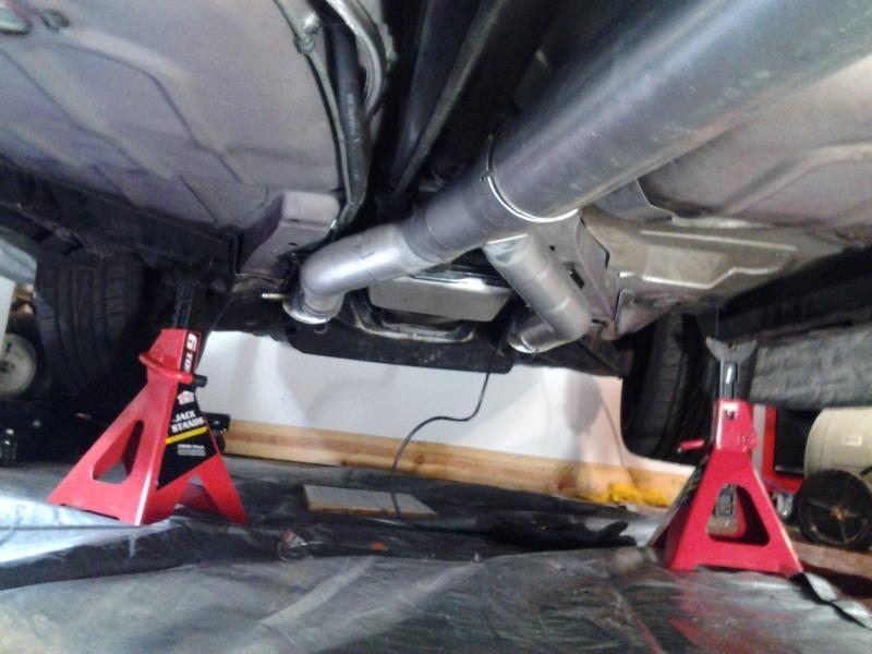

My set up.
Attached Thumbnails Mufflex Exhaust-20160729_183506.jpg   Mufflex Exhaust-20160729_182908.jpg   Mufflex Exhaust-20160729_182559.jpg

That's where you get your good ground clearance from under the cross member, If you had a UMI torque arm relocation cross member like me and Tony your ground clearance would be just like ours. Try routing exhaust around one of those and get back to me

Been their and done that. But looking at your clearances you might want to follow suit.
