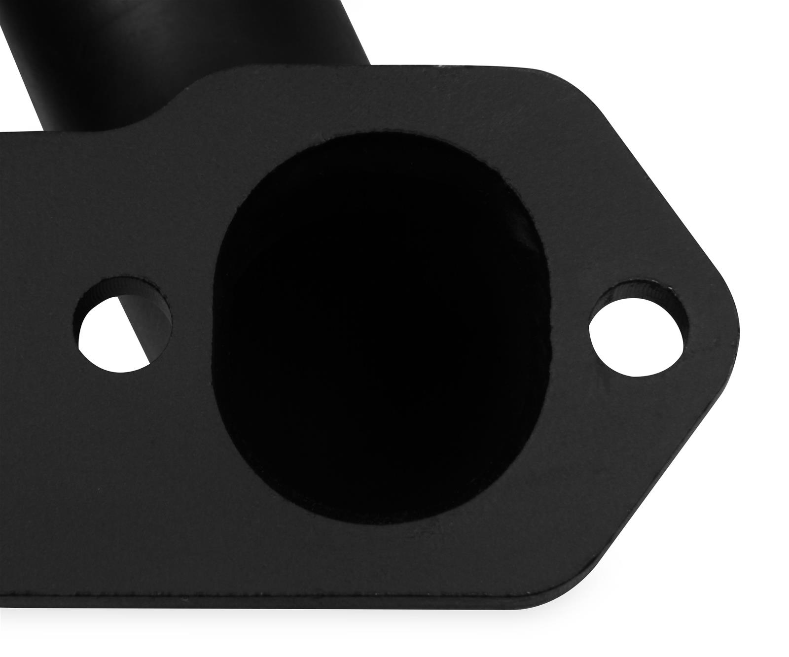

Is this true, even if I have the factory dual cat option (G92, N10, whatever RPO code it is)? Looking at the y-pipes, $280 for y-pipes, costs more than the headers themselves lol. Plus, in the picture it appears as if the pipes are designed for the single-cat exhaust setup. I could be wrong, I haven't been under the car in a while. I just didn't want to spend $280 on y-pipes that were made for single cat cars.

They're not a bad deal. I think you get what you pay for, and not a bit more. Reportedly the Doug's Y-pipe will bolt up and it's less expensive. Both the Doug's and Hooker's Y-pipe necks down to 2.5" at the Y. Some people don't care for the 3 bolt flat flange either. Unless they've changed the design in the last few years, the photos of the exhaust flange shown on the website don't look anything like the ones on the actual headers. I have a set from a few years ago, and the ports aren't anywhere near that clean, and the tubes protrude a bit.
