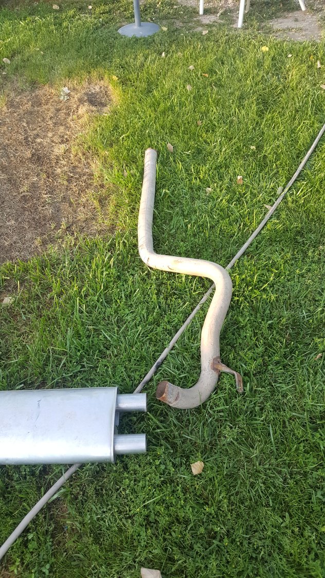

Anyone have part numbers for factory replacement mufflers? I have a new muffler already but the openings are too small for the factory cat back. Don't want to weld it on seeing is its too small. Would prefer a slip fit like stock. Restoring a 1le

What size inlet do you have? The factory performance exhausts used 2.5" inlets (the stock 2.75" I pipe necked down) pretty much for all the 3rd and 4th gens. I'd bet that there's a walker PN for it, but it will likely be the same for all performance 3rd and 4th gen models.
