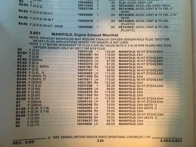

See where it says "Originally Posted by TransamGTA350 View Post". That's a link to the source. It doesn't really matter who looked it up that time. Anyone can look up the part numbers in the GM catalog and see what manifolds were used where. You can look yourself, or take his word for it, or my word for it. Personally, I'd find a copy of the Parts and Illustrations catalog, even if it's a PDF that you might find somewhere on the History subforum, and verify it for myself before I spent any money, but that's just me.

Drew, so your are saying the printed data comes from the GM Parts Catalog? I did not see any TGO poster acknowledging GM as the source. Even by clicking the aforementioned "LINK". And viewing "TransamGTA350"'s post of 12-25-13
I am not an English Major, but it is a general procedure, when quoting information to acknowledge the source of said information. It lends credibility and reliability to the information.
If you are trying to get the most power out of stock stuff, the dual cats are where it's at. The manifolds are bad, but it's the Y-pipe that's really the problem with the single cat setup.

There's actually different manifolds for 1986 and earlier V8s and 1987 and later V8s. So there are at least 4 different pairs: 82-86 small, 83-86 large, 87-92 small and 87-92 large.
The difference is due to the new heads introduced in 1987 with the center-bolt valve covers.The valve cover mounting surface is wider on the 87 and later heads.
If you have the 87 and later heads, you need to use the later exhaust manifolds. 14094063 (LH) and 14094064 (RH) are the later manifolds with the large outlets.
If you try to bolt early manifolds to late heads, you will likely have problems....something to keep in mind when buying used manifolds.
