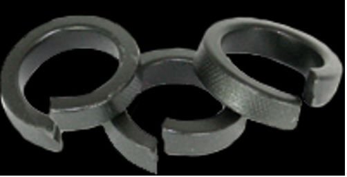

I use 12-point bolts with 3/8" heads for headers. Also really like the RemFlex gaskets, but after adding a set of high collar lock washers (one retightening after a few heat cycles), I never had a problem with leaks (backed off bolts) with any gasket I used.
The high collar washers are cheap at your local hardware/nut and bolt place. Just make sure the bolts you have are long enough. If needed you could pick up some longer 3/8-16 bolts while you're there with the 12-point 3/8" heads - at least my local nut/bolt store have them. Last time I was there the bolts were like $0.60 each - seems like 12, 1" bolts and the .125" thick high collar lock washers were around $10.
