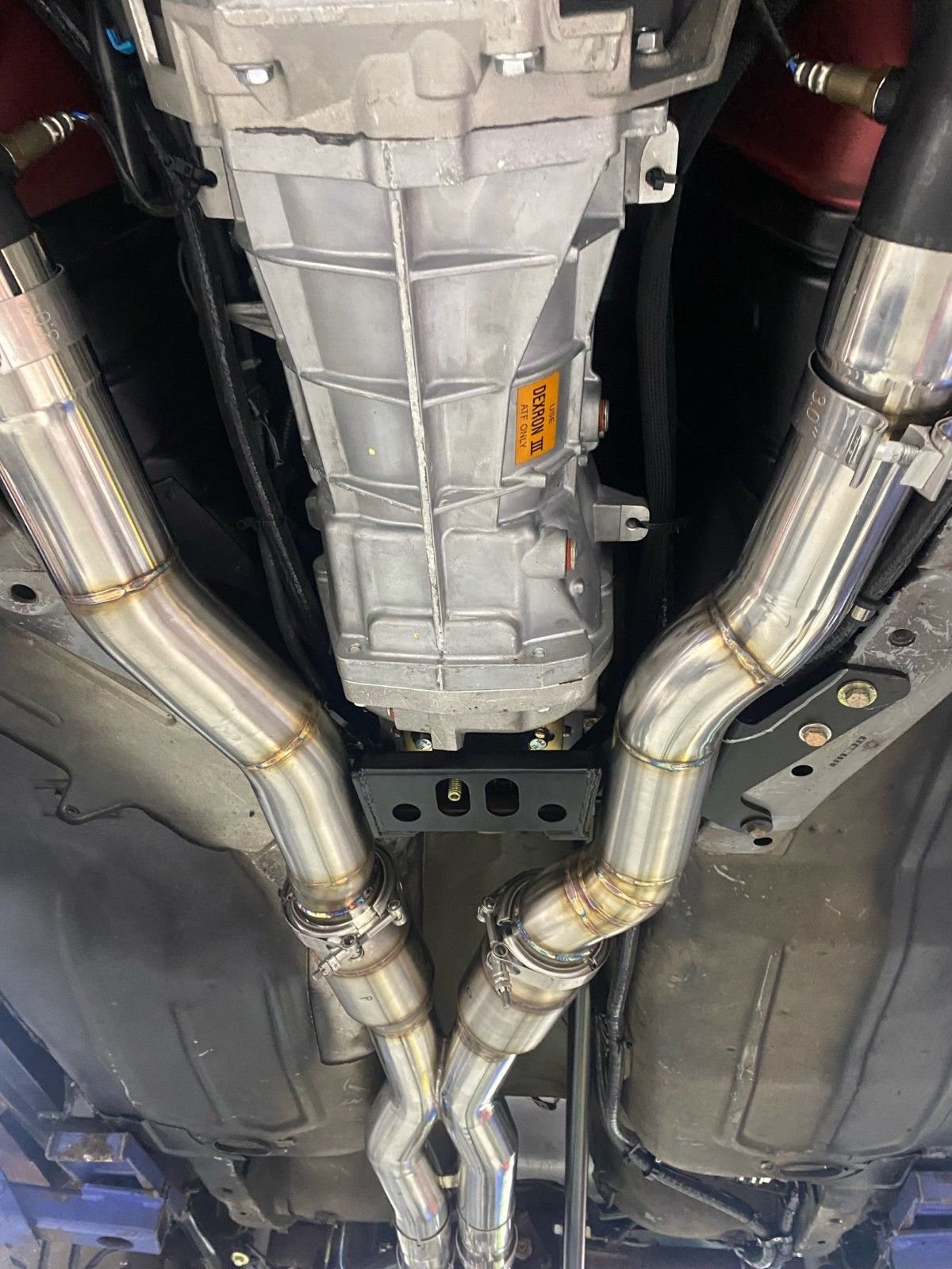

Unless you go with the Holley blackheart true dual system you will end up having to custom make one. Or limit some of the custom work by starting with a 4th gen speed engineering kit (way overkill for your goals). Any particular reason you want dual exhaust? For your power goals a single 3" system will suffice.
Here is a pic of my set-up. I have long tubes though and LS swap. Everything else is what you'll be facing. This is not for the faint of heart. Dual exhausts do not fit naturally under these cars and unless you don't mind banging and scraping yours up, you'll spend thousands to get it custom form fitted to the underside of your car.

I think that is your best bet. Not to mention, an exhaust like this leaves little room for mufflers, which means you often are forced to use bullet style which are loud and prone to drone. I needed a 600hp exhaust so it was this route or maybe a mufflex single 4". I kinda wish I did that instead, even if I lost a few ponies.
