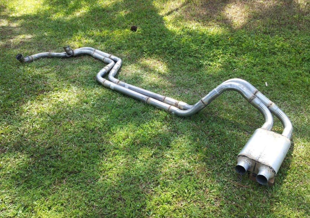

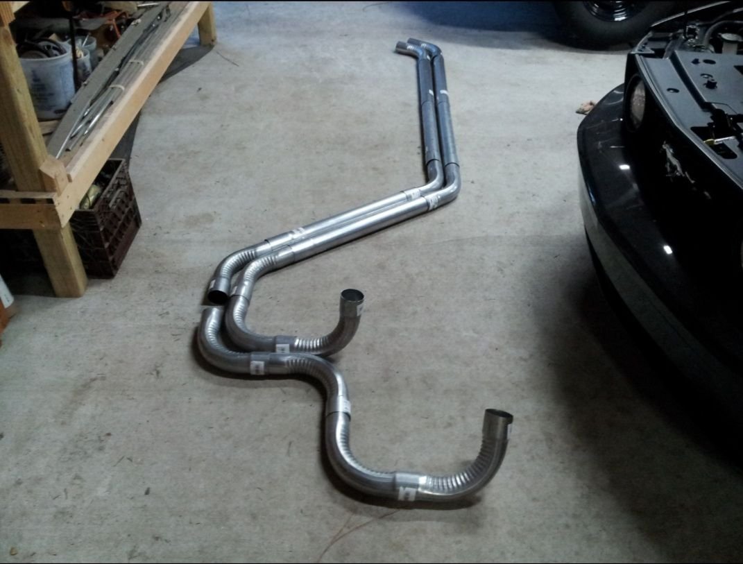

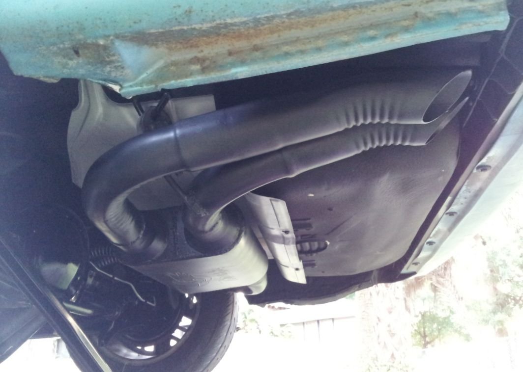

Here is a dual exhaust system i did with the Hedman shorty headers ,yes i know its ruff lol 😆 definitely would do mandrel bend exhaust

I think that exhaust looks pretty good! I love the routing/packaging! Mandrel bent pipe would be better....but what you did there is probably better than good enough, and definitely way, WAY better than stock!

clean tuck on that exhaust by the fender area Sir. My hedman y-pipe that I've had a 3inch 90deg bend added to hangs down embarrassingly low. Hopefully the GFX (91 TA) will help with the shame
