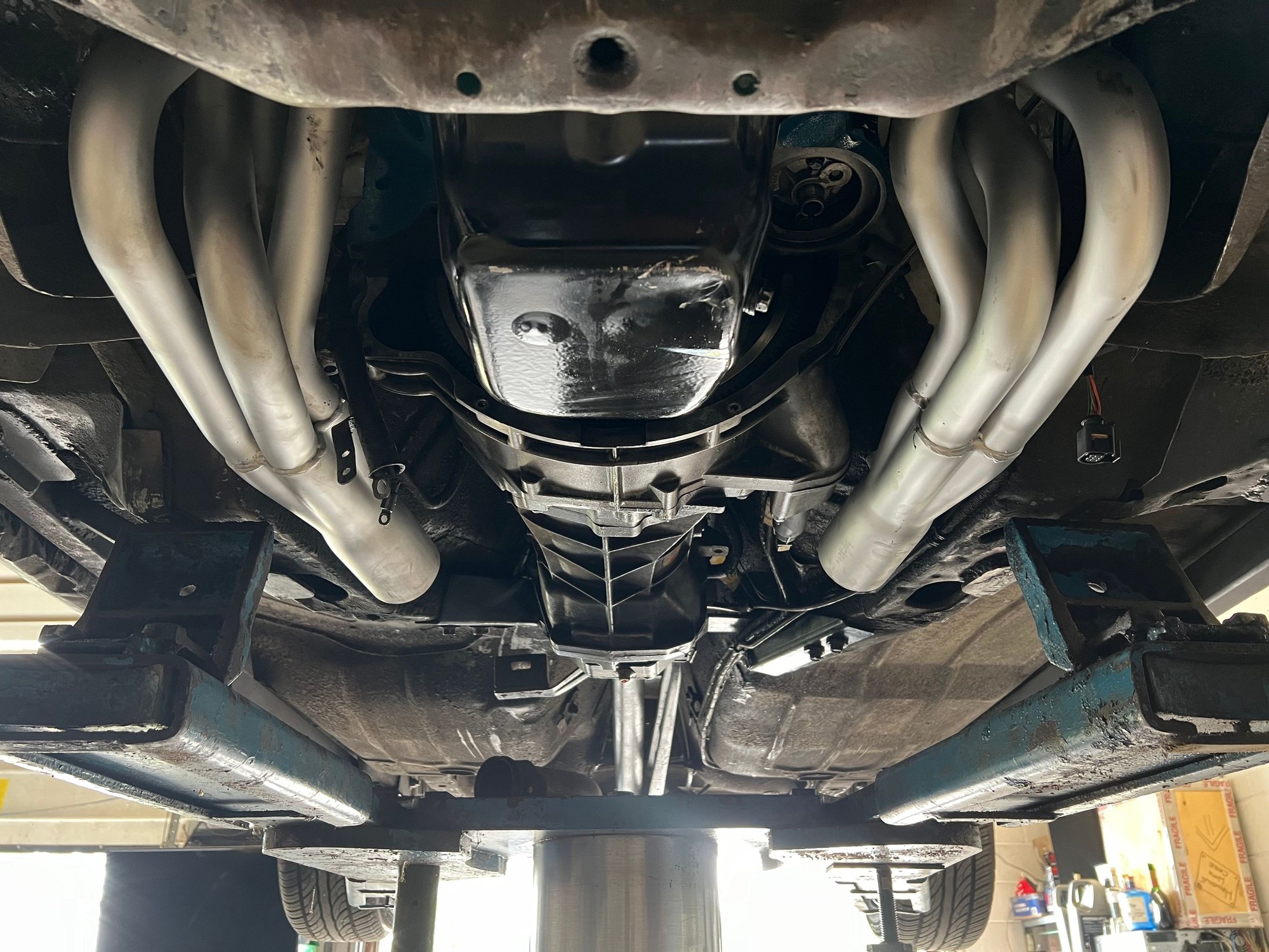

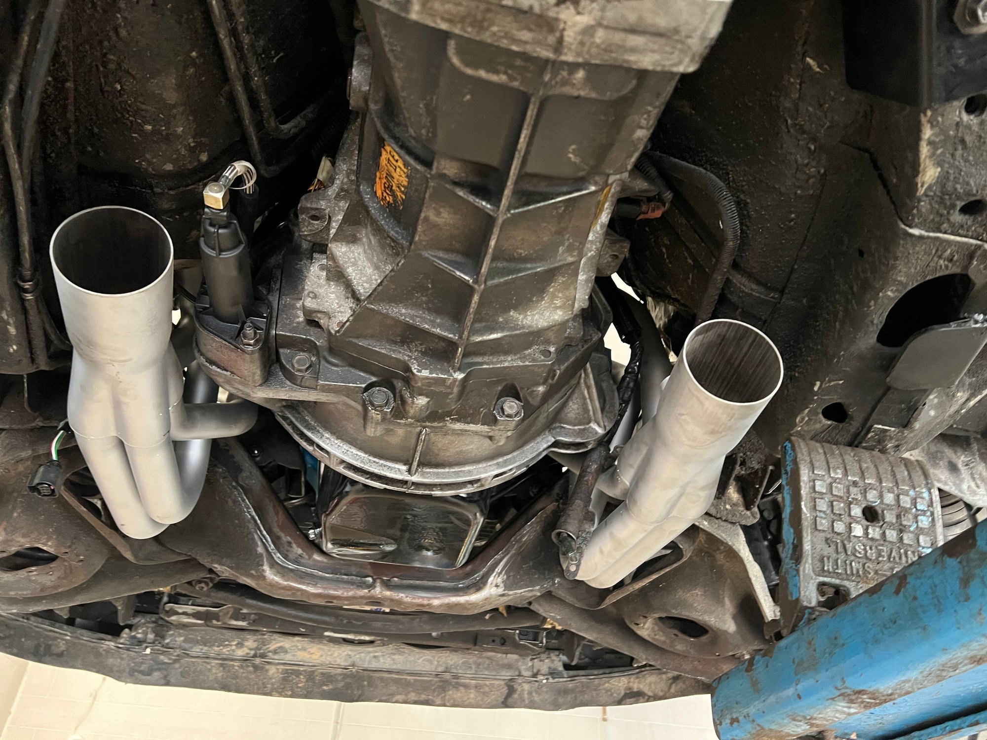

Finally got around to installing my blackheart headers, going to need some heat shielding for the clutch space but it’s going to sound great!
Any recommendations for heat shielding my master on the t56?
I am thinking I should have picked up the full exhaust and made life easy, but alas they are discontinued by the looks of it.
Discontinued Aparently since I bought them but they fit amazing!
Any recommendations on heat shielding for the clutch master?

  1. Have the headers ceramic coated if they aren't already. It's ASTOUNDING how much less heat gets out with that in effect.
  2. Wouldn't be too hard to take a piece of sheet metal, make 2 tabs, bend them up at 90°, wrap it around the cyl, and bolt with the hardware that's already there.

#2 is essentially what a factory one is. Although I seem to recall that an actual factory one didn't fit on the T-56 slave for some reason butt I haven't looked at mine lately to see if I left it there after the swap.
Old Sep 23, 2024 | 11:47 AM
Posts: 28,012
Likes: 2,492
Re: Hooker Blackheart long tube install
On 2nd thought, the reason the factory T-5 heat shield couldn't be used, was because the "nuts" that the bolts holding on the cylinder went into, were part of it. The T-5 bolts went through the BH from the front, then through the SC, and threaded into the heat shield. The T-56 SC bolts are longer, and screw into the BH from behind, through the SC and spacer. So it was fundamentally incompatible.

I used the DEI Versa Shield starter heat wrap with exhaust ties for the slave cylinder. No issues for the last 2 years
