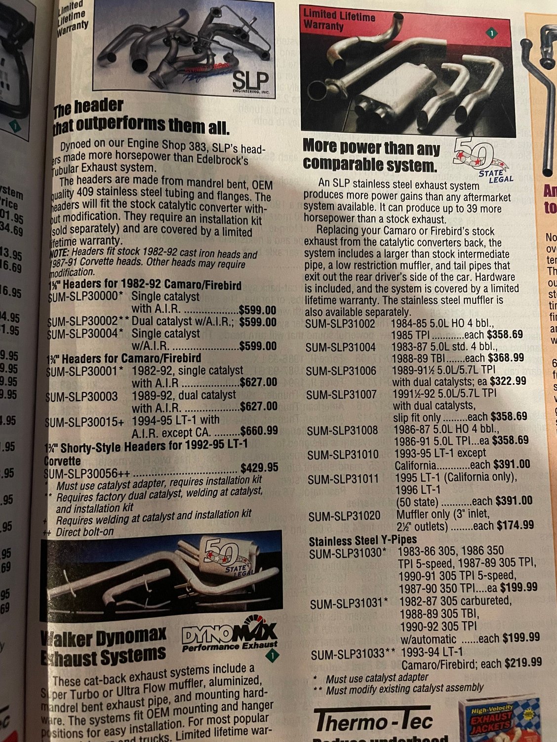

Originally Posted by 88 350 tpi formula
yes you are correct SLP had the y-pipe for stock manifolds.
There's an old Summit catalogue
