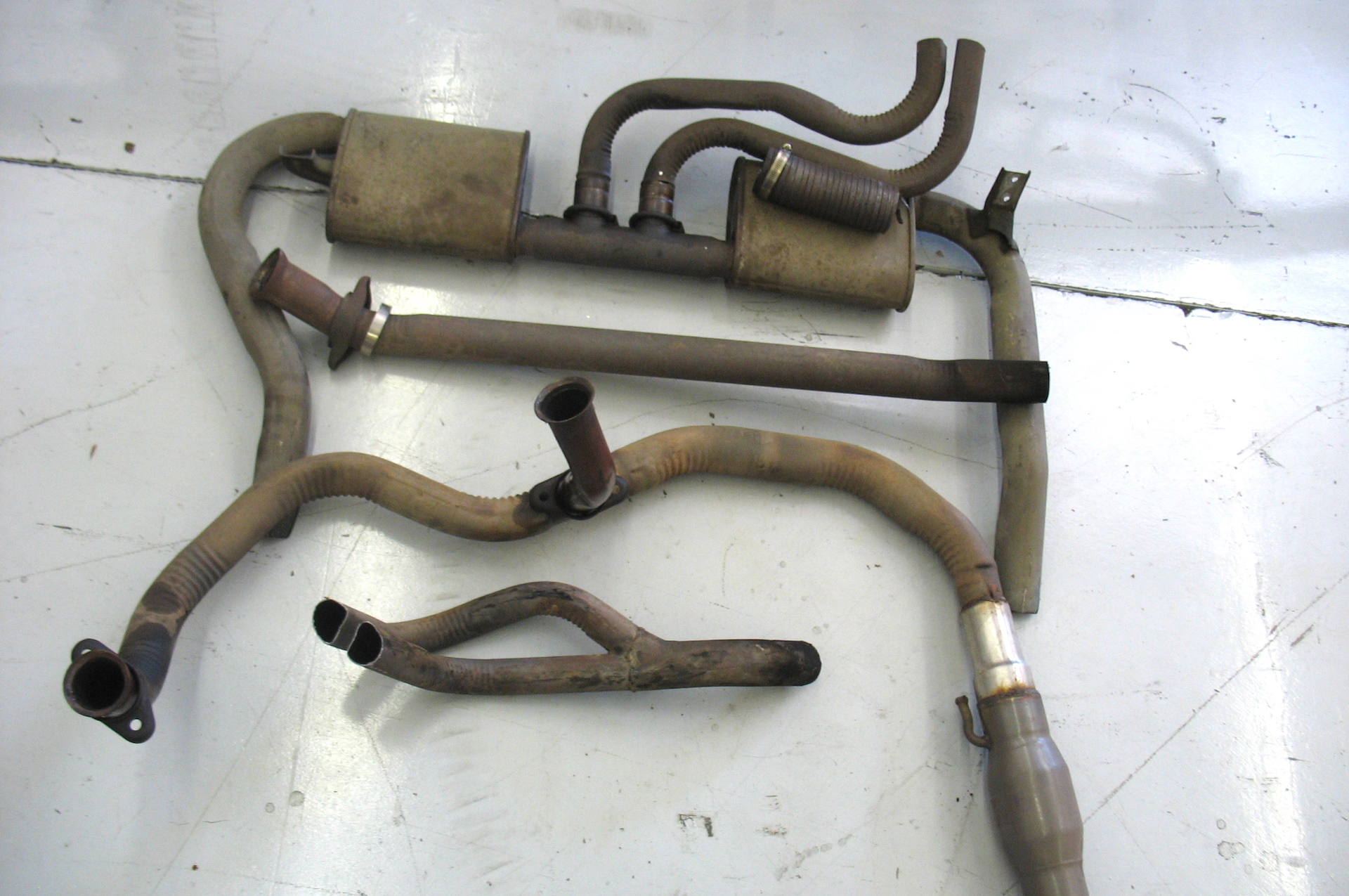

Then, I wonder what would happen if you split it like the early OEM system, but used 2" or 2.5, rather than 1.5? Or what ever it was back then? and had each pipe go through a "turbo" muffler. I know those don't flow great, but for sound....I wonder how that would sound on your car.
The 2 pieces in the middle are the Y pipe and the intermediate pipe, that connected to the Y at the bottom that split into 2 smaller pipes going up over the axle, and on the other side the 2 smaller pipes went into the center pipe which went into the mufflers on either side and out the tailpipes.
For those of you that don't know, the early 3rd gens had a crazy factory exhaust with small dual mufflers, This is the only picture that I could find. The 2 pieces in the middle are the Y pipe and the intermediate pipe, that connected to the Y at the bottom that split into 2 smaller pipes going up over the axle, and on the other side the 2 smaller pipes went into the center pipe which went into the mufflers on either side and out the tailpipes.

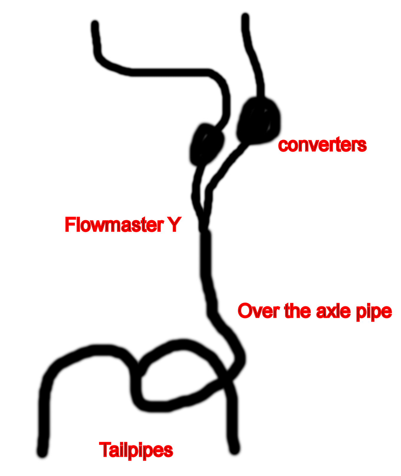

I actually had something similar on my '83 CFI car but I installed headers, made a dual 2.5" cat y pipe, 3" OTA pipe, from there it looped around to the center of a 3" U-shaped pair of 3" tailpipes
Something like this sounded great, but wouldn't pass emissions. I could never get the flow the same from one side to the other, and if one pipe measured lower than the other, they assumed that you were trying to pump air into the exhaust to lower the emissions, and you automatically failed. Of course, this was in 1991, when the car still needed to pass emissions.

[img alt="For those of you that dont know, the early 3rd gens had a crazy factory exhaust with small dual mufflers, this is the only picture that I could find.
The 2 pieces in the middle are the Y pipe and the intermediate pipe, that connected to the Y at the bottom that split into 2 smaller pipes going up over the axle, and on the other side the 2 smaller pipes went into the center pipe which went into the mufflers on either side and out the tailpipes."]https://cimg2.ibsrv.net/gimg/www.thirdgen.org-vbulletin/1920x1275/image_5794f29915f0d4cc70b4a5c8671e21573c88e692.png[/img]
[img alt="Something like this, this sounded great but wouldnt pass emissions, I could never get the flow the same from one side to the other and if one pipe measured lower then the other they assumed that you were trying to pump air into the exhaust to lower the emissions and you automatically failed.
Of course, this was in 1991, when the car still needed to pass emissions."]https://cimg9.ibsrv.net/gimg/www.thirdgen.org-vbulletin/1360x1613/image_62c31b062a5e9933c6f89ff45d519aa13ad21862.png[/img]

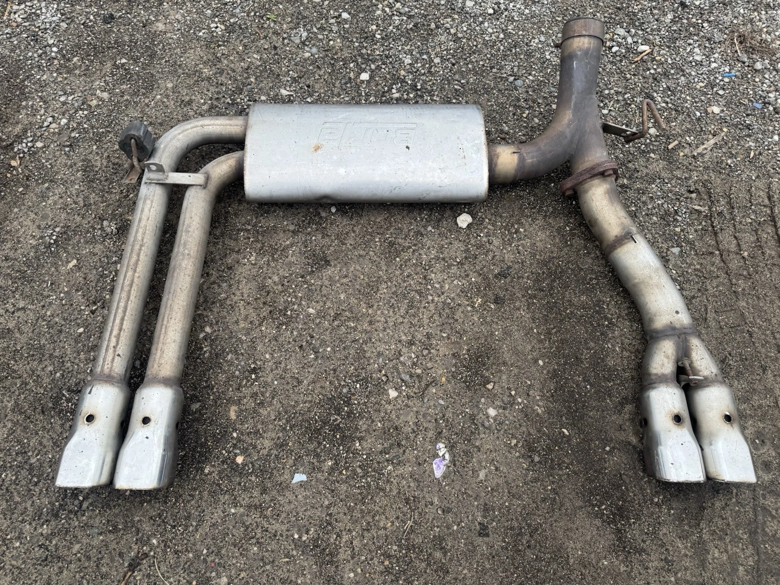

  • At some point I wanted to try putting a Y in the back an running a small muffer on each side, I know that I have a pair of polished 3" stainless bullets/short glasspacks (don't remember the brand) that I intended to try in that configuration, I'm guessing that this would be too loud with the current engine configuration, I intended to put that on after adding a turbo
