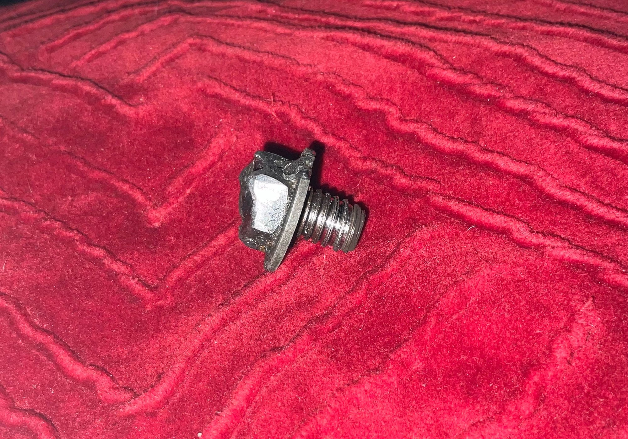

Got it oust by welding nut, but threads leave a little to be desired, any suggestions?

any suggestions?
Sure. You could maybe tell us where it was. Manifold to head, Y-pipe to manifold, etc. Maybe even, was it just a "bolt", or was it one of those "studs", with a place to attach some other thing (oil dipstick for example) with a nut.
A photo of a broken-off threaded thing with a nut oddly welded to it doesn't help us know what part it is that you need. Maybe even, a photo of where that came from.

It was a exhaust manifold bolt, the threads are in the head

Use a basic 3/8" 16 gr 8 bolt. Whatever the length of the manifold hole plus 3/4"
If you need the mounting stud, then try dorman 675217. PS manifold had a bunch of odd lengths, so that kit may not do the job. Last ditch, use a piece of 3/8" threaded rod and nut. I had to for one stud
