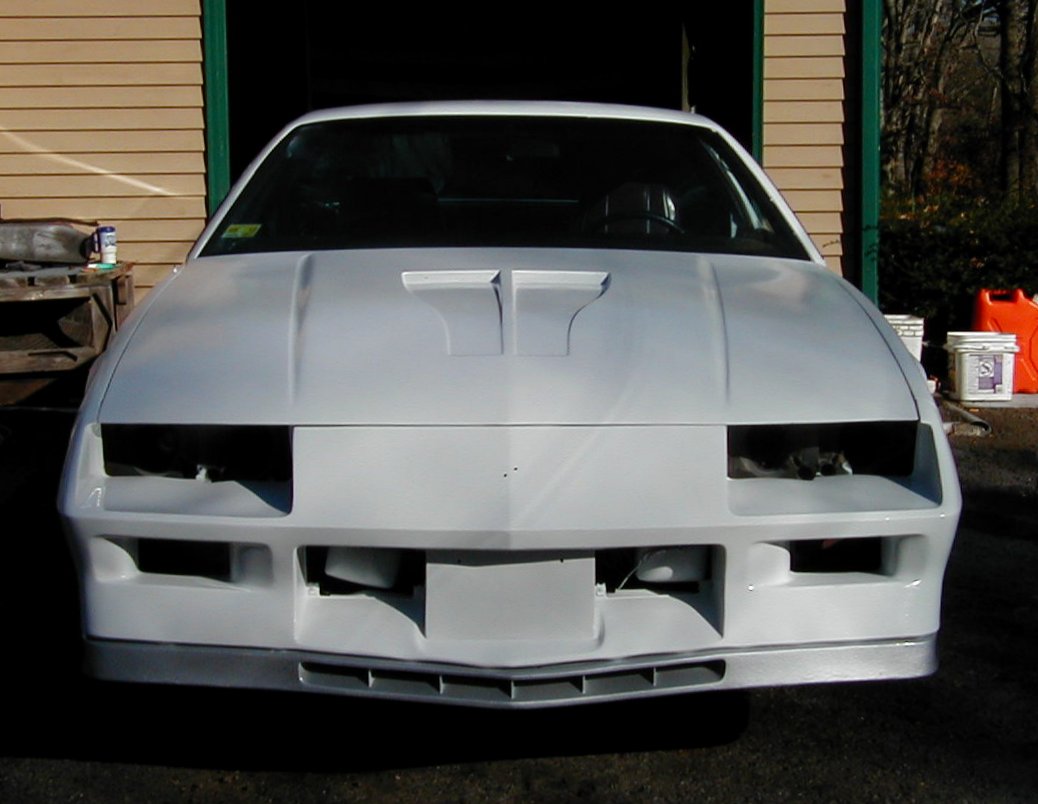

Just fiberglass the holes shut.
I had an 83 crossfire with factory cowl openings. When I converted to Carb I simply put blue tape on the top of the hood to close the openings, flipped the hood, and fiberglassed the back of the holes closed. Once the fibreglass epoxy/resin started to cure I pulled of the tape; nice flat surface, looked fine, worked great, cheap.... and best of all - Holes sealed !
It's sure going to be faster than trying to find someone willing to cut up a factory glass hood !

Thanks John. This is my back up plan. Sounds like it is now my primary plan. Thanks for posting to see that someone else did this.
