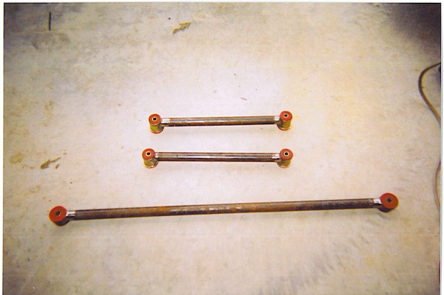

LCA'S
SAW WHERE YOU GUYS WERE BOXING IN YOUR CONTROL ARMS. FOR THE SAME TIMA AND PROBABLY MONEY YOU CAN BUILD A SET. I BUILT MINE AND A PAN HARD BAR IN A LITTLE OVER AN HOUR WITH SOME 1" O.D. PIPE....
Attached Thumbnails ghetto fab LCA's-c-documents-settings-steve

Kickass92z, what did you use for rod ends?

When I rebuilt my suspension, I went to Home Depot and got some Schedule 40 1/2" and 1" pipe. I took the panhard bar and one of the LCAs in and the Home Depot guy cut the pieces to length for me for free. Then I had the pipe welded in and it works GREAT! Considerably more tight feeling over stock. I also went with a polygraphite bushing set front & rear, so that helped, too.

Galvanized. I ground a healthy bit into the pipe and into the LCA where the welds were going. I put three welds down each side (6 total) on the LCAs and 5 down each side (10 total) on the panhard. I think it was AC welded, if I remember correctly. Doesn't look too pretty, but it's strong.

Nevermind i miss read, i thought you MADE the phb and lca's from pipe.

...Am I the only one who did a triple-take on kickass92z's picture? Maybe it's my lack of sleep but to me that appears to be tubing welded directly to the bushing shells.

lol it kinda looks that way to me too... might wanna reinforce those units there...

Hey you guys that boxed your own LCA's and track bar (panhard rod), how'd you protect the inside from rust? Or, didn't ya?
All I can figure is I'll leave a gap in the bottom for water to drain...
That's all that's kept me from doing this, for, oh, 5 years?

I'm just running steel pipe -- I didn't fully enclose the LCA. Driving a bit dries them out; but then again I drive the car every day. I'd put a little more thought into it if it sat for days at a time.
