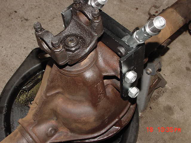

ok lets try this again

That is the jegster mount?

s-plane lucy?

well if that is how jegs manufactured their piece i think they could have done better. a company like jegs with the machinery they probably have could have done something better than a million and a half washers. it does look beefy ill give ya that but washers? that many?

The washers are just to maintain even spacing between the plates. That way you don't have to take the rearend out of the car to fab up the bracket.
I've used washer stacks a few times.....works very well.

allllrighty then,back to the thread at hand
any one else have any exerience with fabbing thier own TA?here is a thread with some usefull info.
i plan on usingthese for my adjustable TA

pic 1

So how much narrower or shorter did you have to make the 5 7/8 X1 1/2 piece? Can you take some measurements and repost demensions for the bracket?
Sorry to be a PITA but my cars put away for the winter so I cant get under it rite now and your useing the same rear I am.
Old Nov 19, 2004 | 08:22 PM
  #50
91banditt2's Avatar
Joined: Dec 2000
Posts: 2,341
Likes: 151
From: Cincinnati,Ohio
Car: 1991 BandittII Firebird
Engine: 5.7 HSR
Axle/Gears: 3.27 9 bolt
1 5/16" wide
