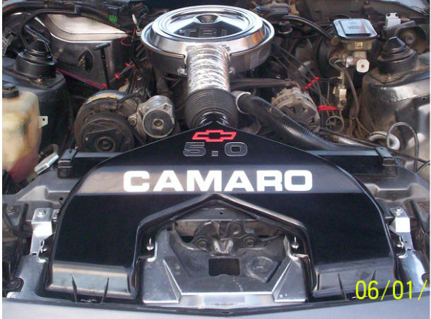

i`ve done this myself and the blower will work but you won`t get any airflow through the car.what are you intending this car to do? is it going to be a strip only car or is it your daily driver?what i suggest is getting a non ac box off the internet or go to your local junk yard.i got lucky and found one where i live for 15 bucks.Or do a search here and you`ll find that some other people fab up thier own with some fiberglass.sorry so long just trying to help.

here`s a pic of mine to give you a clue as to what the look like.(the are normally black but i polished mine.)
