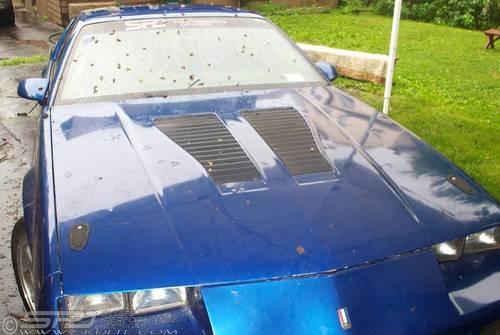

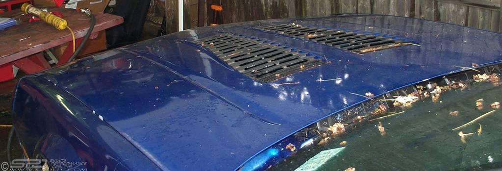

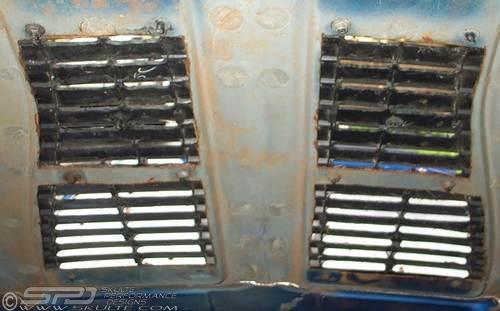

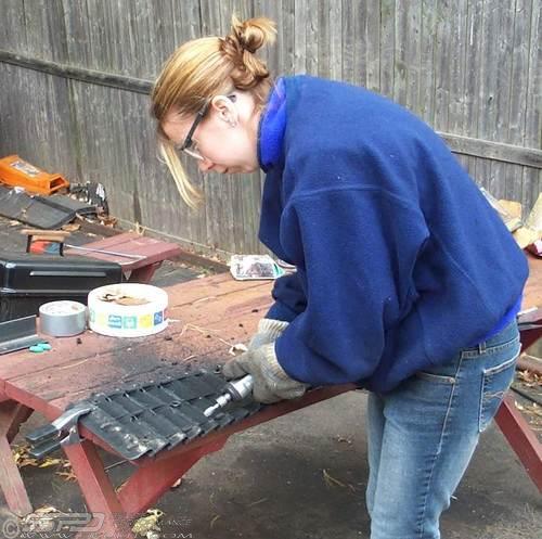

At Watkins Glen, the Z28tt was getting very floaty at higher speeds, especially from the rammed air through the sealed off intercooler/radiator duct assembly getting forced under the hood. There was no other place for the air to exit, except for out, under the car. This creates higher pressure under the hood, which results in lift at the front of the car, rather than downforce. Louvering the hood was the next step before doing a radiator extraction duct similar to the C5R.
I used a hot air gun to loosen the adhesive blobs holding the very thin inner hood support to the outer hood shell, and removed that. Once the center section of the inner hood support was removed, I cut the hood skin in between the louver mounting holes. Finally, my lovely helper (thanks KW!) used a die grinder with an aluminum cutting bit to cut the base of each fin open.
Gallery pictures at:
http://www.skulte.com/gallery/view_a...C-Hood-Louvers
You can barely tell! (Those are new Aerocatch hood latches in the front corners, since I removed the factory hood latch to remove the hood load on the intercooler).

That's one of the coolest 'stock' body mods ever- when I repaint my car I'm seriously considering doing that.
I hate most body mods on thirdgen's but I think that is the best mod I've seen so far - thought about it for 15yrs - now Andris does it-

I am currently in the process of making my louvers functional. Though it turns out that the previous owner super glued them to the hood so it's taking while to slowly are carefully pry them off without cracking them.
