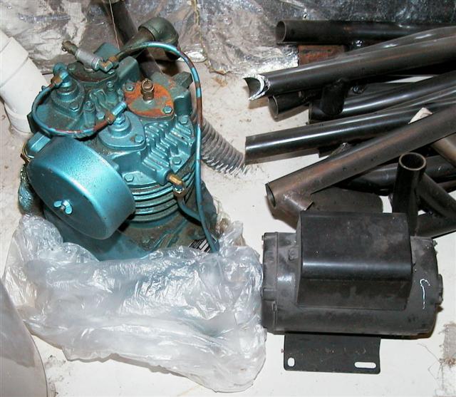

Kind of like the compressor head that I'm playing with (btw, I'm goign to check and see if I can find a K&N for that air fliter housing, that freaking thing has what looks like a standard but smallish automotive filter in it), that thing orignally came with a 575V 3 phase on it also...

Heh, I'm way ahead of you there... I'm a cheap bastard and not about to spend real money on something like that, if I didn't find a new filter for cheap I was planning on using a '04 mustang filter housing and filter that I had sitting around or just a normal filter housing even.
You probably saved me some time there anyway, if they're expensive I doubt that I'll even go looking for one when I need it. For the time being though the one that is in there looks practically new.
Looks like it's just a piece of threaded pipe coming into the back of that so it would be extremely simple to adapt to other housings, worst case, whip out the plasma, cut the base out of that and then weld it into the new filter base... 5 min worth of work and no money and I'm done...
Huh, now that I’m thinking about it, I have 2, roughly 9” K&N’s left over from my crossfire… I bet that they’d make a pretty slick air filter for that thing
