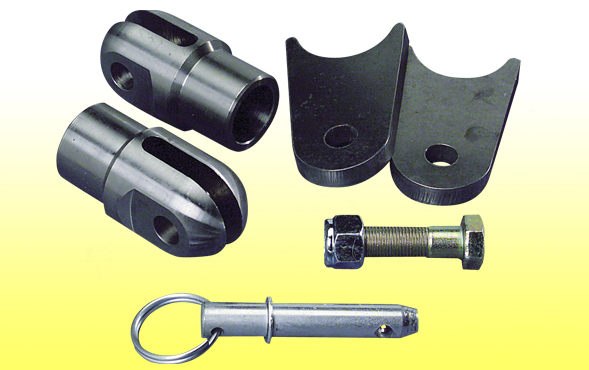

would this worth it to do on my roll bar
I put a 6 pt roll bar in my car mainly for looks but Im sure it helps strengthen the chassis as well. The problem is that now I cant recline my seats due to the cross bar being right behind the head rest. Would it be wise to weld in this clevis kit which will allow me to remove the bar when I want to go out for a cruise with the kids or something? I wont use those pins to secure it. iwill use high grade bolts that fit VERY tight. I will use this bar to mount my 5 pt harness when that day comes as well. here is a pic of something I would like to use.

well what makes it legal on the side bar then? I figure I will go to the track about 2 or 3 times a year and mainly at special events only. I figure my car will run in the 11's. I just dont want my rollbar to become totally usless and unaeffective. Basically do you think it will hold up ina wreck(worse case senerio)

anyway to answer your question.
yes, the pins will shear in a rollover, letting the main hoop collapse. i wouldnt trust them in the way you're describing.
plus, thats where your seatbelts mount to...
plus, its not NHRA legal (or IHRA, or SCCA, ect..) anyway

if the pins sheer in a rollover then wouldnt they sheer in a side collision. say someone t boned you right in the drivers door. These are advertised as a swing out kit for roll bars/cages.
Also, in my first sentence of this tread I said that this cage was mainly for looks only. If my car was running 10's then no I would even cut the bar out to install these. But with me doing nothing but daily driving with htis thing, I feellike having a removable crossbar is a good idea. especially when I need to get in there to do some work. its a PITA crwling under the bar.

Do what "YOU" want to do. It "YOUR" car man. if your not racing in sanctioned events/bracket racing at the track you should be fine. Depending on your tec guy. as you said You put it in for looks and to stiffen it up a little. Ive seen a few people do what you want to make it removable.
I just ask you DON'T put your kids in the back with the bar in. You readdy dont have much room From seat back to the bar is aprox. 15inches or so. Not much room at all.

Door bars are not as much a part of structural integrity as the cross bar for the main hoop. That is why they can get away with it, but remember swing out bars are only legal until 11.99 if i remember correctly.

"A roll bar is required in any convertible running 13.99 seconds or quicker in the quarter mile, and in other cars beginning at 11.99"
so i think that the swing outs go to 11.49 and higher if im not mistaken
