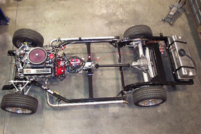

i would add subframes to it. should help with any twisting of the body.
maybe at a strut tower on the front of the car.
like shown in this photo
the bar going across the engine. that should help as well.
or its shaking madly because you put a diesel in an F-body lol. im not to sure if there is a cure for that or not..

You're pioneering into new territory here. Aside from some race car applications, I don't think anyone has put an actual frame on an f-body that I've ever read about and I've been researching, driving, wrenching on these cars on and off for 10+ years.
If I thought you were going to keep the factory suspension, I would say the easiest way to run the frame would be to follow the factory subframes as much as possible, then cut them out, weld steel back in to re-enforce the body where you removed it and create body mounts, then bolt up your frame there.
But since you're talking 4-link etc.... I could be wrong, but I think it might be best if you welded some tubing horizontally perpendicular to the body to re-enforce it (temporary) and then just cut all the sheet metal out of the floor of the car from front to back. Ran your frame how you wanted it... ran your exhaust, fit your gas tank and spare if you choose to have one, and then make your own floor to put back in the car.
Since this is such a huge project anyways, you might even want to consider removing the dash, and cutting and and smoothing the firewall while you're at it.
Another thing to consider... again, this is such a huge project, but adding the full frame would definitely make the chassis as strong as possible (in a stock sense). You could do some mods that other people have only considered, like a Targa top, or Suicide doors.
Oh, lastly, and more practically... if you're going to do your own frame... make sure you take a close look at incorporating things like an x shaped crossmember to stiffen up the center of the chassis, and a drive shaft loop.
Go to protouring.com and look for some information on John Parson's Nova. He posts there regularly. Popular Hotrodding did at least 3 articles on his car that I know of. The long and short of it, is he built a G3 Nova in his driveway with nothing more than help from guys he found on protouring.com.

now we are talking. I am getting some ideas on the how to fabricate this frame. Here is what I am thinkingI am thinkin of taking 2x3 rectangular tubing and following the channel around the floor boards. Removing the front subframe completly and using something that would resemble a front nova clip but instead of bolting the clip to the body welding the clip to the 2x3 frame. then on the back get some rear frame rails from jegs and welding the frame rails to the 2x3 frame. This would allow the structure for my 4-link.
This corvette frame is what I am thinking of.
